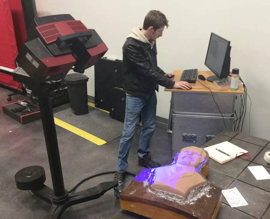

Exact Metrology, distributor of the GOM CT scanner, used the ATOS Triple Scan for each sculpture. The GOM ATOS Triple Scan is a high resolution, optical digitizer that delivers rap-id and precise 3D measuring data for the optimization of design processes. Precise fringe patterns are projected onto the surface of the object and are recorded by two cameras, based on the stereo camera principle. As the beam paths of both the camera and the projector are calibrated in advance, 3D sur-face points from three different ray intersections can be calculated. The projection unit of the ATOS Triple Scan is based on Blue Light Technology. Since the sensor works with narrow-band blue light, interfering ambient light can be filtered during image acquisition. Short measuring times are possible because of the powerful light source.
Then, the data was processed in Exact’s Geomagic, the company’s 3D software for digital models of physical objects. Next, the data from the software was used to create a Styrofoam negative with a CNC machine. Lastly, the negative was taken to a foundry to be poured in the final sculpture.
