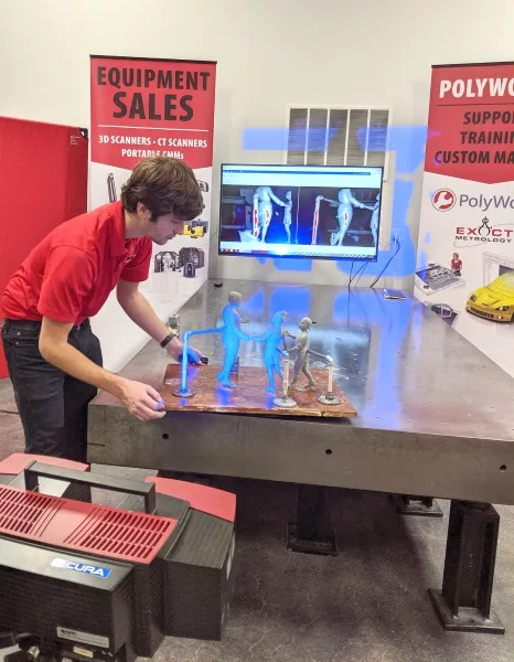

Noah Branscum, from Exact Metrology, scanned the clay model of the figures using the GOM ATOS Triple Scanner. The ATOS triple scan is a high resolution, optical digitizer that delivers rapid and precise 3D measuring data for the optimization of design processes. Thus, it improves industrial production processes. ATOS sensors are used in several industries for the inspection of parts such as: sheet metals, tools and dies, turbine blades, prototypes and injection molded and pressure die cast parts. It offers advantages in measuring reflective surfaces or objects with complex indentations. The software of the sensor is continuously monitoring the calibration status, the transformation accuracy, environmental changes and part movement to ensure the quality of the measuring data.
Ronnie Hensley used Geomagic Wrap to make the scan data (mesh file .stl) water-tight and scale it to actual size. Geomagic Wrap enables users to transfer point cloud data, probe data and import 3D formats into 3D polygon meshes for use in manufacturing, design, entertainment, archeology and analysis. The software intelligently processes complex point cloud data to revolutionize the way digital design and manufacturing is performed. It also revolutionized 3D printing, prototyping, and engineering. Tom then took the files from Exact Metrology and supplied them to other shops to build the statues.
