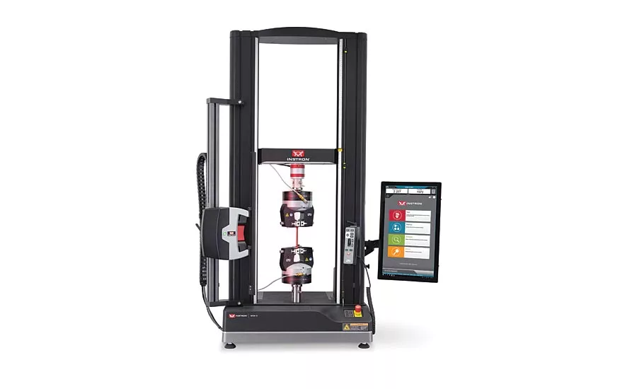

An Instron 68TM Testing System with Pneumatic Side Action grips
Figure 1: An Instron 68TM Testing System with Pneumatic Side Action grips and an AVE2 Video Extensometer. The AVE2 has the capability to perform axial, biaxial, and DIC strain measurements.

The grips or fixtures needed to test wrought or printed specimens will depend on the type of specimen being tested. If performing a tensile test on dogbone shaped specimens, a side action or wedge grip will generally be appropriate (Figure 1 shows side action pneumatic grips). If performing a bend or flex test, a three or four point flexure fixture is the way to go. For components, the fixture choice will largely depend on the property being tested. In simple cases side action grips may be suitable, but for complex components or for companies testing a wide variety of components, a component test plate will offer more flexibility. If you need to test compressive forces at many different points on a component, an automated x-y stage can be used to streamline the test so the operator doesn’t need to keep positioning the component beneath the testing axis.

For tensile tests, it is important that the specimen fails within the gage length and not near the grip itself. If a specimen is failing at the point of contact with the gripping face, this is an indication of stress concentration. There are various ways of alleviating stress in these cases. With side action grips, different torques or pneumatic pressures can be used to try to reduce stress from the clamping jaw faces. (Whenever possible, make sure to report the torque or pneumatic pressure applied to the specimen to ensure consistency between samples.) Different surface finishes on the jaw faces can also help to reduce stress concentration, but they must be suitable to the material and specimen in question.
