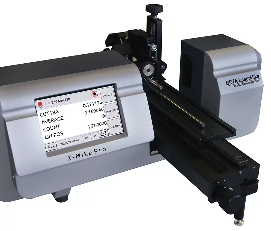

NDC Technologies, a leading global provider of intelligent, connected measurement and control solutions, exhibits its industry-leading Z-Mike Pro laser micrometer at this year’s Quality Show in Rosemont, IL (Booth 611). This widely installed dimensional measurement system with high-performance capabilities enables manufacturers across a broad spectrum of industries to produce precision parts fast.
Z-Mike Pro provides absolute accuracy, reliability and repeatability for dimensional measurements of outer diameter, ovality, taper, TIR, runout and effective cutting diameter, to name a few. Manufacturers facing increasingly tighter tolerances and the pressure to turn out precision parts efficiently rely on Z-Mike’s +/-0.5 m accuracy and +/-0.13 m repeatability to help them deliver superior quality products. Z-Mike Pro offers versatility across a wide range of demanding measurement applications such as rubber rollers, fluted cutting tools, plug and pin gauge calibration, shafts, pistons, crankshafts, camshafts, motor shafts, glass tubes, fuel injectors, valves, computer components and other uses.
From quality clean rooms to tough machine shops, the Z-Mike Pro gauge offers the following benefits:
> No recalibration
> Precision over the entire measurement range
> No need to center the object to be measured
> Measurements traceable to national standards
The Z-Mike Pro gauge is available in two models to measure products up to 50 mm. Ethernet and USB connectivity simplifies integration into centralized production networks and other devices. An extensive line of ready-to-mount modular fixtures are available to properly hold workpieces, from simple manual fixtures to fully automated and intelligent fixtures. All Z-Mike Pro components are backed by a 2-year product warranty. And every measurement system is backed by NDC’s world-class service and support organization. Customers have 24-7 access to NDC’s complete customer service cloud portal – myNDC. Visit www.ndc.com/betalasermike
