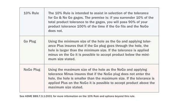

The no-go gage is not supposed to fit into the part. Showing a no-go in the part would be showing an out of tolerance part. Source: Vermont Gage ee ASME B89.7.3.1-2001 for more information on the 10% Rule and options beyond this rule.

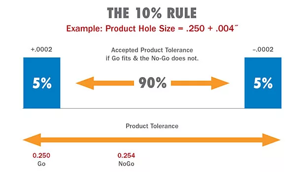

Go and no-go gage dimensions and tolerances are derived based on the product dimensions and tolerances. The general rule of thumb is that the go plug gage diameter (plus tolerance) would represent the smallest diameter of the product tolerance for the hole. The no-go plug gage (minus tolerance) would represent the maximum diameter of the product tolerance for the hole. The sum of the go and no-go gage tolerances should not equal more than 10% of the total product tolerance (the 10% Rule). The go gage is fairly straightforward. The go must pass freely through the entire length of the hole. The fun starts when the no-go is used. The amount of force required for the gage to enter the hole becomes a point of discussion. This is due to a certain level of subjectivity. The questions asked are: How far is the no-go allowed to enter? How much force should be applied? Should the tolerance on the no-go gage be plus?

This is a decision for the informed gage user. The discussion usually starts by someone stating that you can’t put a .250” diameter pin into a .250” diameter hole without some allowance (tolerance) for fit. If the hole diameter tolerance is .250” +.004”, then the minimum size is .250” (go) and the maximum size is .254” (no-go). The operator/manufacturer states they are allowed to manufacture up to .254” diameter. Based on the part specification, the part is in tolerance at .254”. If the tolerance on the .254” no-go is applied Plus (i.e .2540 +.0002), there is an opportunity to accept product larger than the maximum .254” diameter.
