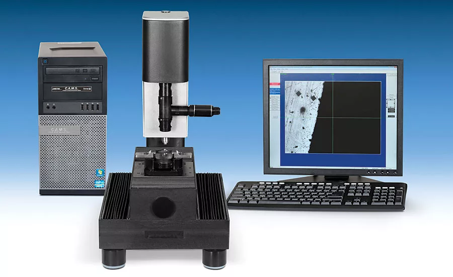

This direct-reading, depth-of-penetration tester uses a conical diamond indenter and 1000gms for the major load. It employs the preliminary load / total load / preliminary load progression comparable to what is used on all Rockwell hardness testing instruments. Source: AMETEK Inc.

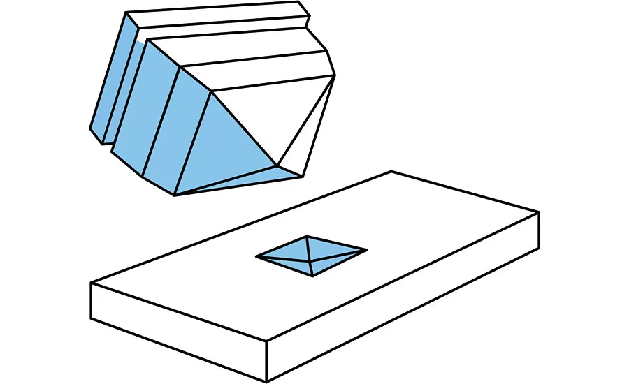

Vickers indenter faces are set at a 136 degree angle from one another. Source: AMETEK Inc.

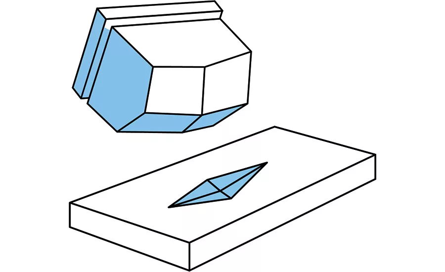

Typical Knoop indenter geometries. Source: AMETEK Inc.

The microhardness indention testing method was developed over time as an outgrowth of the Standard Brinell hardness test. Robert L. Smith and George E. Sandland at Vickers Ltd developed the pyramid diamond indenter in 1921 as an alternative to the Brinell test method to measure smaller areas and higher levels of hardness than where capable with the standard Brinell ball indenters.
The Knoop test was developed by Frederick Knoop and colleagues at the National Bureau of Standards, the current NIST in the United States. The Knoop method uses an extended pyramid with face angles that are 172 degrees for the long edge and 130 degrees for the short edge. Both Vickers and Knoop are defined by the ASTM E384 standard.

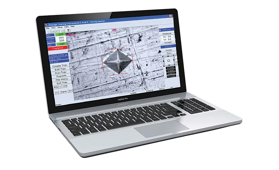

Where the need for more frequent or higher volume testing is required, some level of computer assistance is a benefit. Most microhardness testers, regardless of age, can be adapted to a computer assisted measuring system (C.A.M.S.) that allows on-screen, automatic measuring and analysis through a camera and software installation directly on a PC or laptop.
With today’s technology, impressions can be read in a much more repeatable manner by computers, and in a fraction of the time! Another benefit is that computers do not get bored, or tired. They have a greater sensitivity for shifts in contrast and an ability to repeat their measurements.
The alternatives to traditional optical microhardness testers are direct-reading, depth- of- penetration testers that utilize the direct reading, depth of penetration based on the Rockwell principle of testing with microhardness appropriate loads. As these devices are measuring depth, they are not influenced by the operator and can read on far rougher surfaces. Test cycle times also are reduced dramatically. In other words, these microhardness testing alternatives can reduce the risk of operator error even further.
