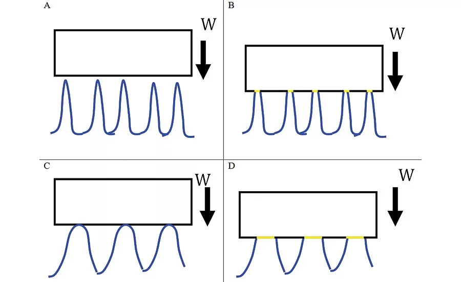

Figure 2. When small radii asperities make contact elastically with a flat, smooth, rigid/hard surface (A-B) the real area of contact is smaller compared to larger radii asperities making contact (C-D).
sliding friction

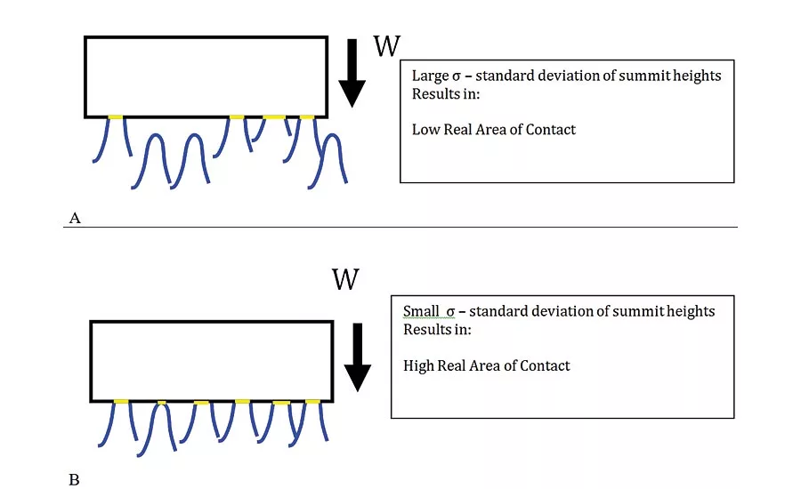

Figure 3. For a large standard deviation of summit heights, the real area of contact is lower (A) than for a small standard deviation of summit heights (B), for the same summit radii, materials and load.
sliding friction

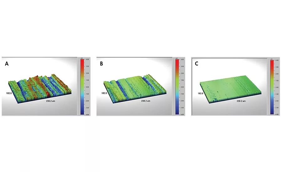

Figure 4. 3D surface texture measurement of a sliding surface that initially started in a highly rough condition resulting in some degree of plastic deformation/plowing (A) and thus high friction. After running-in the resulting surface tended to stabilize in an “elastic” regime of contact and thus some moderate sliding friction (B). Toward end of life as the surface was further polished the lower roughness resulted in a higher real area of contact and thus higher friction (C).
sliding friction

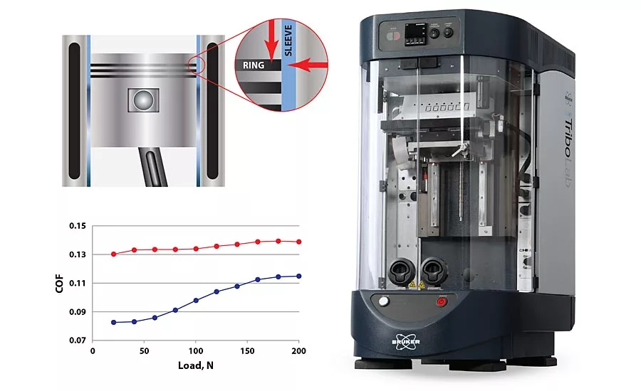

Figure 5.  A Universal Mechanical Tester (UMT) used to measure friction between various test components (A) and a typical friction vs. load measurement performed with a ring on cylinder configuration (B). The red curve and blue curve are for different lubricants that were tested.

If the asperities have small radii, R, (e.g.  “needle type”), assuming elastic deformation, the real area of contact will be small and thus the sliding friction reduced. If however the asperities have large radii, R (e.g. “balloon type” structures) the real area of contact will be larger and thus the friction will be higher (Figure 2).
Figure 3 demonstrates the dependence on the real area of contact
(and thus sliding friction) on the standard deviation of the summit heights (i.e. related to the average roughness, Ra). For surfaces composed of a large summit height deviation (i.e. high Ra – rough surface) the real area of contact may be small resulting in low sliding friction, whereas a low Ra surface (i.e. smaller deviation of summit heights) will result in a higher real area of contact and thus higher friction.
Thus, assuming elastic deformation at the points of contact, adjusting the surface texture by modifying the asperity localized radii and/or overall average roughness will affect the friction. In the elastic regime, lower roughness, Ra will usually result in a larger real area of contact and thus higher friction.
So indeed, in the case of elastically contacting surfaces the solution to reducing the friction is to “make the surface rougher!”

Figure 4 demonstrates measurements made with a 3D optical profiler of a surface under sliding conditions that evolved from the plowing (A) mechanism (i.e. high sliding friction), through to the plastic mode (B) of deformation (i.e. moderate degree of sliding friction), to the elastic mode (C) where the real area of contact had greatly increased (i.e. high degree of sliding friction—possibly seizure with mating surface).

The measurement of the friction between sliding surfaces may be readily performed with various instruments. Figure 5 demonstrates the universal mechanical tester (UMT) which has many optional modules that allows for different friction system simulations. Using systems like the UMT the friction forces (or frictional coefficient, COF) may be measured as a function of various conditions such as load, distance traveled, degree of lubrication etc. Q
