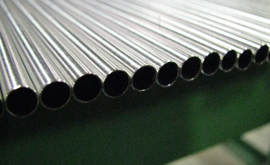

An example of tubing subject to ultrasonic testing.

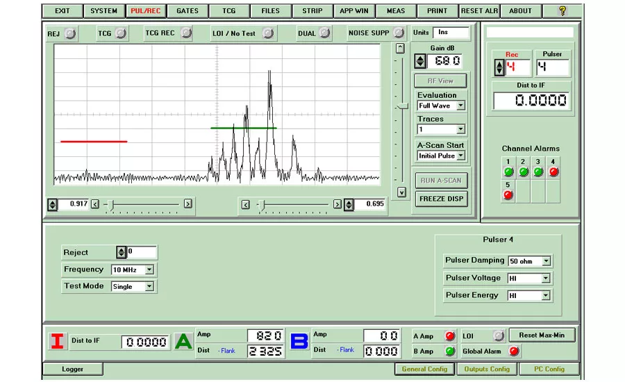

The ultrasonic signal from a typical defect.

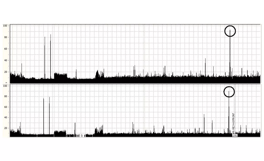

A chart recording showing the indications from the reference standard (left) and a typical defect (circled, right).

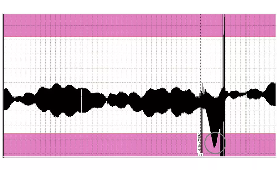

A chart recording showing a region below the minimum required wall thickness.

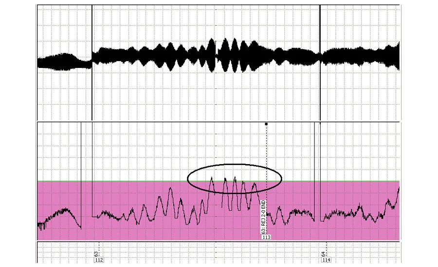

A chart recording showing a region with too wide a variation in wall thickness.

Ultrasonic testing uses high-frequency sound waves to inspect the surface and the interior of materials. A probe converts an electrical pulse into a sound wave, the sound wave travels into the material through a liquid coupling medium and reflects off any boundaries it encounters, whether a defect or another surface of the material. A portion of the reflected sound is received by the probe, converted to an electrical signal, and displayed on a screen.
The time taken for the sound to travel gives information on the size and location of defects or the thickness of the material. For defect inspection, the amount of sound received is compared to the sound received from a precisely manufactured artificial defect, called a reference standard. This comparison allows a technician to estimate the size of a defect compared to the known reference standard. For wall thickness measurement, the time taken for the sound to travel through the material is measured and converted into a thickness measurement.
In this example, the material is round metal tubing with a very precise outside diameter and wall thickness. This material will be inspected for surface and subsurface defects. Additionally, the wall thickness and the variation in the wall thickness will be measured.

The circled regions on the chart on the previous page recording show where the signals received from the probes exceeds the signals received from the set of known defects in the reference standard (shown at the left of the image). These indications show that this region of material contains defects which are larger than those in the reference standard.
This circled region on the top chart recording shows where the wall thickness of the tubing is below the required thickness. Material which is too thin will produce parts with regions which are too thin, which might fail in service.
The circled region on the bottom chart recording shows where the wall thickness variation is above the allowable amount. Too high a variation in thickness can generate wide variations in finished part thickness, which can be unsuitable for service.
