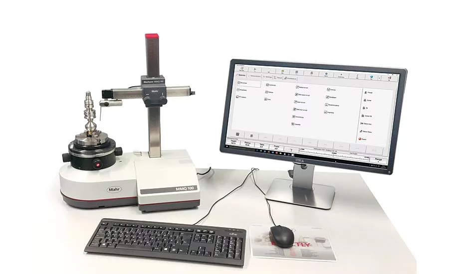

Form software itself is another area where “easy” can be deceptive. Form measurement is a highly sensitive process of measuring small variations in shape that was traditionally performed in climate-controlled labs by highly trained specialists. Move that process out onto the shop floor and have it performed by non-specialist operators and you introduce a host of variables and potential problems. Modern error compensated machines and the software that goes with them are, of course, intended to control these variables and mitigate these problems. That makes it easy, right?
But easy for whom? Another friend of mine likes to joke that “a good user interface for software is like a good joke: if you have to explain it, it isn’t.” Typical form metrology systems offer a very standard software interface. Think Microsoft Excel or Word: when you open the software you always get the same screen with the same menu bar and pull-downs. It is always familiar, but how many of you know what all those functions and commands really do? Some form systems offer add-ons that enhance capability, but these are usually seen as additional pull-downs or buttons: none of them change the essential appearance of the interface.
Such a user interface is fine, if you are a trained metrologist and understand all the terminology and details necessary for form measurement, or a programmer who understands code. But if you are a machine operator, even one who is expert at running today’s highly sophisticated machine tools, the intricacies of form measurement can be daunting.
Some manufacturers of form measurement systems offer simple, touch screen or point-and-click software interfaces that facilitate the measuring process. But these can present the opposite problem: if you are an engineer, or quality manager who knows a bit about programming, and you want to do something beyond point and click—you want to do some custom measurements, set up a new application, or combine a series of measurements, for example—accessing the machine via the point and click interface is no longer easy. In fact, it can be extremely frustrating trying to work within the boundaries of all the automated functions that are trying to “help” you.

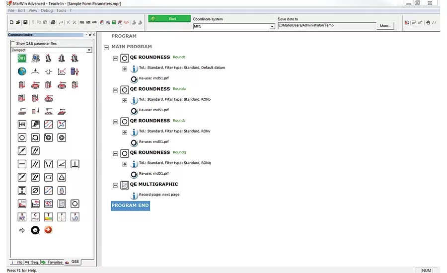

A better option is to provide multiple levels of interface: an easy, advanced, and professional level if you will. The philosophy behind this approach is to tailor the user interface to the task at hand. These interfaces look nothing alike. The easy interface is point and click, feature oriented: the word ‘program’ is never mentioned. An operator can put a part onto the machine, look for a symbol on the machine that looks like the symbol on his drawing, hit that symbol and make the measurement without having to understand anything about programming.
The more advanced interface is a programing interface with icons that you build programs with using a tree-like structure you can expand and collapse, or add nodes to. The top level, or professional interface, allows users to program via detailed code in a text editor. But all of these interfaces—easy, advanced and professional—are simply different ‘front ends’ to the same software. Thus, a program, or complex measurement series created in one of the higher levels, can be executed in the simple level and vice-versa.
Easy is having form software that can adapt to the skill level of the user and the current task at hand, not one which forces them to adapt to it.
