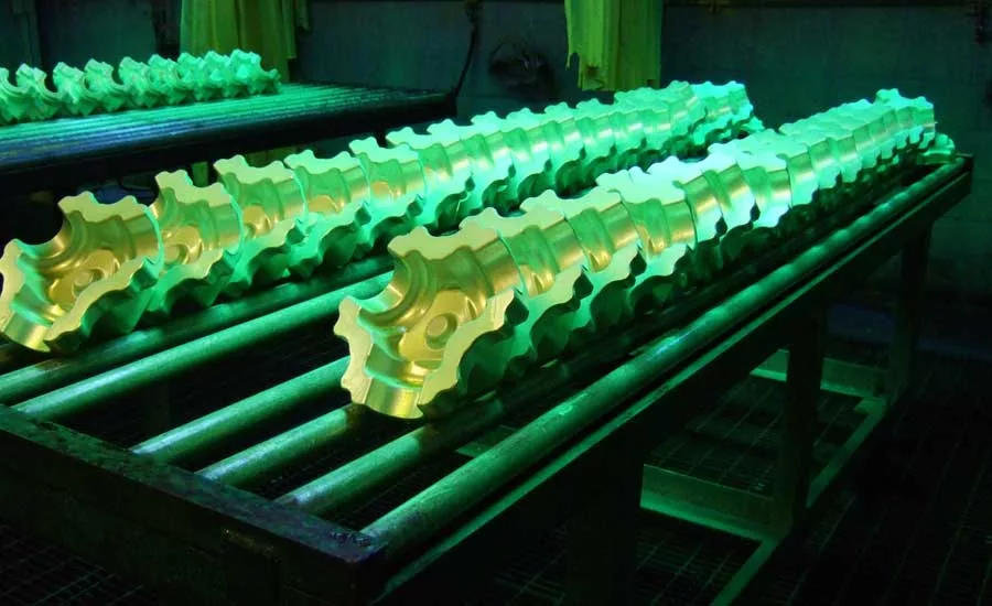

Aerospace parts undergoing fluorescent penetrant testing.

Fluorescent Penetrant Inspection (FPI)
Described by the British Institute of NDT as a “simple low-cost method of detecting surface-breaking flaws,” cracks as small as 150 nanometers can be identified using FPI.  However, the restriction of this method is that the flaw must reach the surface of the material in order to be detected.
cracked engine mount
A cracked engine mount found with magnetic particle inspection
There are several steps to this process: first, the surface of the test piece must be very clean and free from all contaminates. Then the penetrant is applied; this may be done via dipping, spray or brush etc.; after a specified time, the excess penetrant is removed from the surface. At this point a developer is applied to facilitate the surface inspection and pull the penetrant trapped in the flaw back to the surface. In the past this was done visually although in recent years, some organizations have begun to automate the inspection process via television or camera for robotic pattern recognition. Finally, a post-inspection cleaning to protect against corrosion should be applied.
