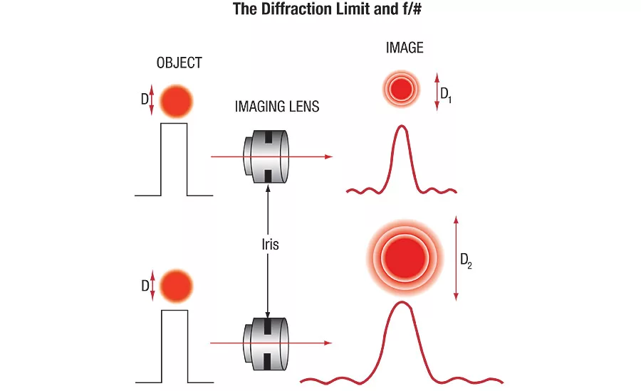

Figure 1. The upper diagram shows the relative spot size created with a lens with its aperture open wide. The bottom portion illustrates how the spot size from the same lens increases as the aperture is decreased. The top image shows the aperture set to a low f/# while the bottom image shows the lens set to a high f/#.

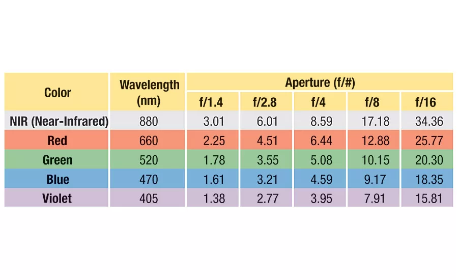

Table 2. Theoretical Airy Disk
Table 2. Theoretical Airy Disk diameter spot size (in µm) for various wavelengths and f/#s.

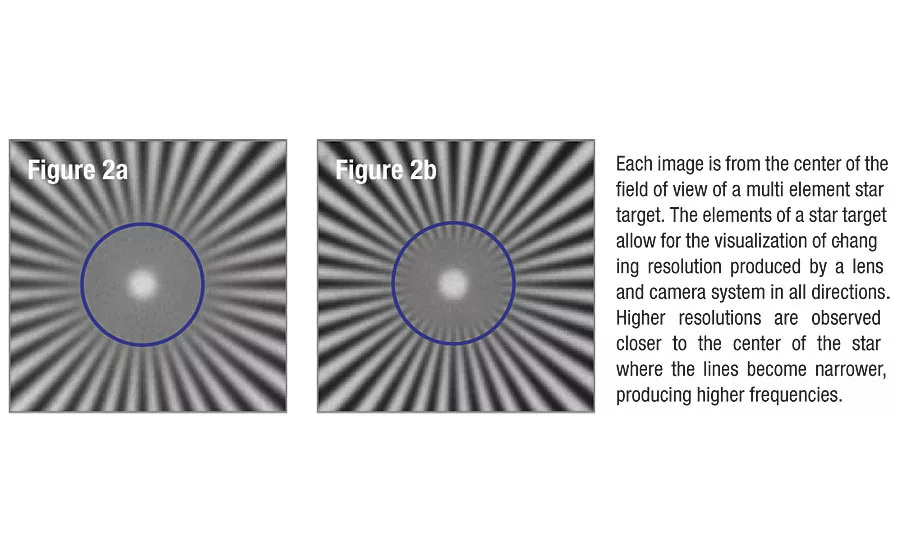

Figure 2. Images of a star target taken with the same lens, at the same f/#, with the same sensor. The wavelength is varied from 660nm (a) to 470nm (b).

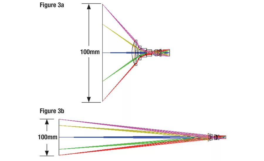

Figure 3: Two lens designs, (a) and (b), with the same field of view and very different working distances.
Both lenses in Figure 3 are imaging the same field of view onto the same sensor, but the lens in a has a working distance of half of its field of view, while the lens in b has a working distance of 3X its field of view. The light passes through the lens in a at extreme angles and the light on the edges of the field of view (magenta/red) have a much longer distance to travel than the light in the center of the field of view (blue). In contrast, the lens in b achieves the same field of view at shallower angles with a smaller path length difference. As a result, the lens in b features a much less complex lens design and provides superior performance at a lower cost.

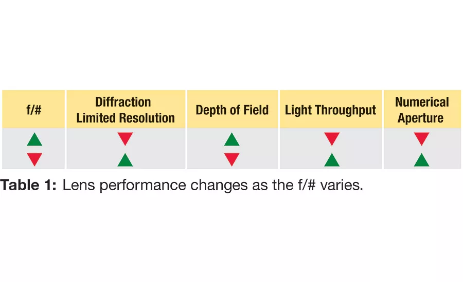

Table 1: Lens performance changes as the f/# varies.
This shows the relative change to a number of key system parameters as f/# is changed.

Changes in f/# cause several changes in system performance. Generally, changing the f/# is done by adjusting the iris setting of a lens. Figure 1 illustrates the change in relative spot size with a change in f/#. For a lens of a given focal length, a larger aperture represents a smaller f/#. Closing the iris down to a smaller aperture represents an increase in f/#. As shown in the figure, a lens with a smaller f/# produces a smaller Airy disk, indicating that the lens can image smaller details in a scene. But other performance parameters also change with f/#.
As can be seen in Table 1, widening the aperture (iris setting) of the lens will increase the theoretical resolution. But that reduces depth of field—the ability to see object information at different distances away from the lens. Maximizing resolution requires the f/# to decrease, while increasing the depth of field requires the f/# to increase. Essentially, physics dictates it is impossible to have very high resolution over a large depth of field. To optimize both resolution and depth of field, designers need to make compromises or seek more elaborate solutions, such as using multiple imaging systems.

Lenses typically focus light of different colors at different distances, which tends to make the spot size larger. Reducing the wavelength range as much as possible will enhance any lens’s performance. As seen in the diffraction limit equation, wavelength is one of the variables that affect spot size. Table 2 and Figure 2 each illustrate how spot size (and resolution) changes with wavelength and f/# for a diffraction-limited lens.

Don’t get too close. Due to the constraints of physics, attempting to look at fields of view that are too large relative to a lens’s working distance places excessive demands on the design of the optical components and can decrease system performance. It is recommended that a working distance of two to four times the desired field view be used to maximize performance while minimizing cost. Figure 3 shows some of the implications of selecting a working distance outside the recommended length.
