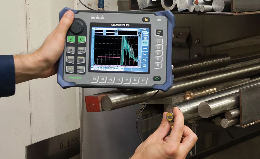

This ultrasonic flaw detector is used to test bar stock for circumferential cracking, chevron cracking, or porosity.

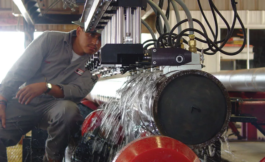

The Rotating Tube Inspection System (RTIS) uses phased array technology to inspect the full body of tubes. This system is based on the "Water Wedge" concept using a membrane to maintain a permanent and stable water chamber providing a fast coupling and short untested length.

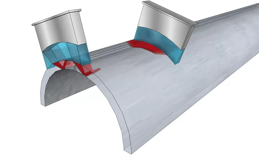

A cylindrical phased array probe is located on each side of the weld to inspect in both clockwise and counterclockwise directions. The phase array beams are electronically steered to generate the desired refraction angle in the tube radial direction.

Manual testing with portable ultrasonic flaw detectors and hand-held transducers is usually the simplest and least expensive technique to implement. An inspector monitors a waveform display while moving a transducer around the test piece. Bar stock testing is performed from up to three orientations, using straight beam and angle beam transducers, which as their names imply aim sound waves either in a straight line or at selected angle for optimum defect detection. The first test involves coupling the transducer to the end of the bar and identifying the echo from the far end. Echoes appearing ahead of that far end echo, or a dropout of that echo, suggest circumferential cracking, chevron cracking, or porosity.
The transducer is then coupled to the side of the bar and moved along its length while also scanning at least 180° of circumference. Internal echoes or far wall echo dropout suggest laminar cracking or piping. Finally, an angle beam probe can be similarly scanned along the length of the bar while scanning around the circumference to identify near-surface axially oriented cracks. That third approach is also the one used for tubing. These basic test protocols and echo interpretations also apply to the automated approaches below, with automated alarms, parts marking and/or imaging software replacing constant human monitoring.

Phased Array automated testing
Further advantages can be gained through the use of automated phased array systems (PA), which utilize multiple-element probes and electronic beam steering to direct and focus sound beams. As compared with conventional UT systems, phased array systems can offer improved detection, ease of setup, consolidation of probes, and faster throughput, thanks to their ability to perform simultaneous inspection from multiple perspectives with beam overlap to insure full volumetric coverage. With conventional automated UT systems, even when two rows of transducers are used to increase coverage, there is typically no physical overlap between the beams from each transducer. This results in some areas receiving lower beam energies and thus reduced probability of detection of small defects.
Through beam steering, PA systems can offer a large physical overlap between consecutive scan zones with little variation in energy across the beam, optimizing the beam profile in the test piece and improving detection consistency. System mechanics can also be simplified thanks to phased array’s ability to steer the sound beam, rather than moving the probe and/or parts only.   Unique pneumatically loaded water wedges are often used to minimize water consumption while increasing coupling reliability, reduce acoustic noise and eliminate need for an inspection tank.  While specifics will vary from system to system, detection of defects smaller than 1 mm at a scan speed of 1 m/s is often possible.
A typical system for bar stock might include two or more ultrasonic phased array probes scanning a rotating bar from two directions.  One probe scans through the center of the bar to locate piping and other central defects, another scans outward to detect radial cracking. Each beam sweeps through a programmed range of angles for full coverage. These phased array test channels are often integrated with an electromagnetic scanner (an eddy current array system) that is used to detect near surface defects.
Inspection of ERW tube welds commonly employs a cylindrical phased array probe on each side of the weld to inspect in both clockwise and counterclockwise directions. The sound beams are steered to generate the desired refraction angles for full inspection of the weld and the heat affected zone.
