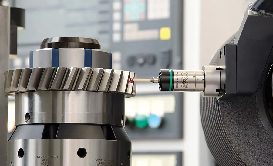

This mechanical gage can be used to precisely locate a gear tooth prior to grinding, and then scan the finished gear tooth profiles after grinding, combining pre- and post-process inspection in a single tool. Source: Marposs

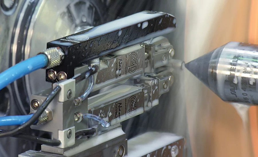

The gage shown here is an example of an in-the-cut measurement device used for controlling the finished size of small, ground parts. Source: Marposs

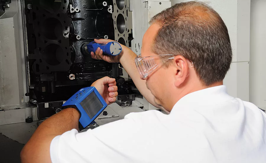

Wireless technology assists in operator convenience for taking measurements to verify parts between metal removal operations. By pushing a button, real time measurement values are displayed on the receiving electronic unit, with the possibility to store the measurement data. Source: Marposs

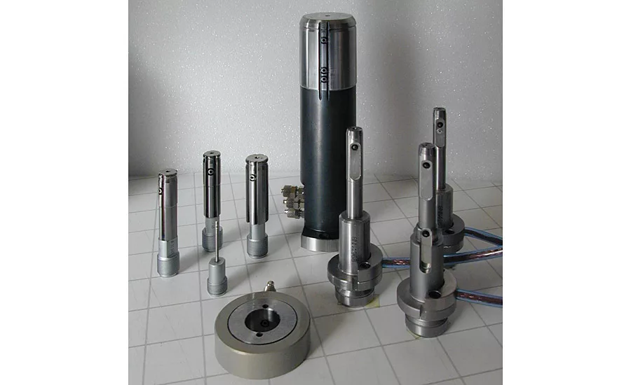

For parts that may have rough surfaces, non-contact air gages such as those shown here will be less sensitive to rough finishes and roundness due to their averaging effect; conversely, the measurement range of pneumatic gages is only about half of that available in a typical mechanical gage. Source: Marposs

Traditional “in-process” gages—or more accurately “in-the-cut” gages—nearly always use physical contacts and electronic transducers to measure the part because that’s the most practical way to deal with coolant, swarf, chips, vibration and all the other factors present at the surface of a part while it’s being ground or after turning. Performing gaging and inspection operations before machining operations, between machining operations and after machining operations also offers much greater mounting flexibility since the gages don’t have to be on the machine or in close proximity to it.

Generally speaking, for ring or plug-type gages air may be a better choice than mechanical contact for parts that may have rough exterior finishes, for example incoming parts that are rough turned prior to finish grinding. Non-contact air gages will be less sensitive to rough finishes and roundness due to their averaging effect.
One downside of an air gage, however, is that the measurement range is only about half of that available in a typical mechanical gage. The air gage also will need both max and min masters, while a mechanical plug or ring requires only a mean master.
Mechanical gages also have inherent limitations. The most important of these are a minimum practical internal diameter of about eight mm, compared to one mm for the air gage and a maximum depth of 150 mm compared to 200 mm. On the plus side, a mechanical gage will almost always have better thermal stability than an air gage.

A variation on this theme is used to finish grind precision helical gears with a form wheel that engages the full face of each tooth while the gear is rotated. Obviously, the tooth and wheel have to mate precisely to avoid a catastrophic collision. This is accomplished with a mechanical gage that locates the tooth precisely and feeds the position data to the grinder control. The same probe is then used to scan the finished tooth profiles after grinding, combining pre- and post-process inspection is a single tool.
