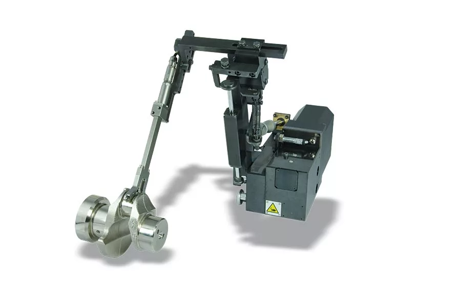

electro-mechanical system
This electro-mechanical system is comprised of electromechanical slides and grinding arms.

For as long as there’ve been in-process gaging systems, they’ve used hydraulic or pneumatic actuators to drive them. Both are simple to implement, well-understood, and since most machine tools come equipped with a hydraulic pump, a compressed air connection, and all of the hoses, piping, filters, manifolds, and valves needed to make these systems function, tapping into them for gaging purposes has made good sense.
Or at least, it used to. Piggybacking a measuring unit onto a machine’s hydraulic system means a bigger pump and motor are needed, increasing investment while driving up operating costs. Compressing hydraulic oil causes heat, and heat causes thermal growth in machine tools, never a good thing when precision machining is involved. Hydraulic oil gets dirty, can potentially leak, and must be disposed of, raising concerns about the environment.
Similarly, the air going into any pneumatic system must be kept clean and dry, something that can be difficult to achieve in many manufacturing environments. And while shop air may seem inexpensive, anyone who’s purchased and then maintained an air compressor will tell you it’s anything but.
