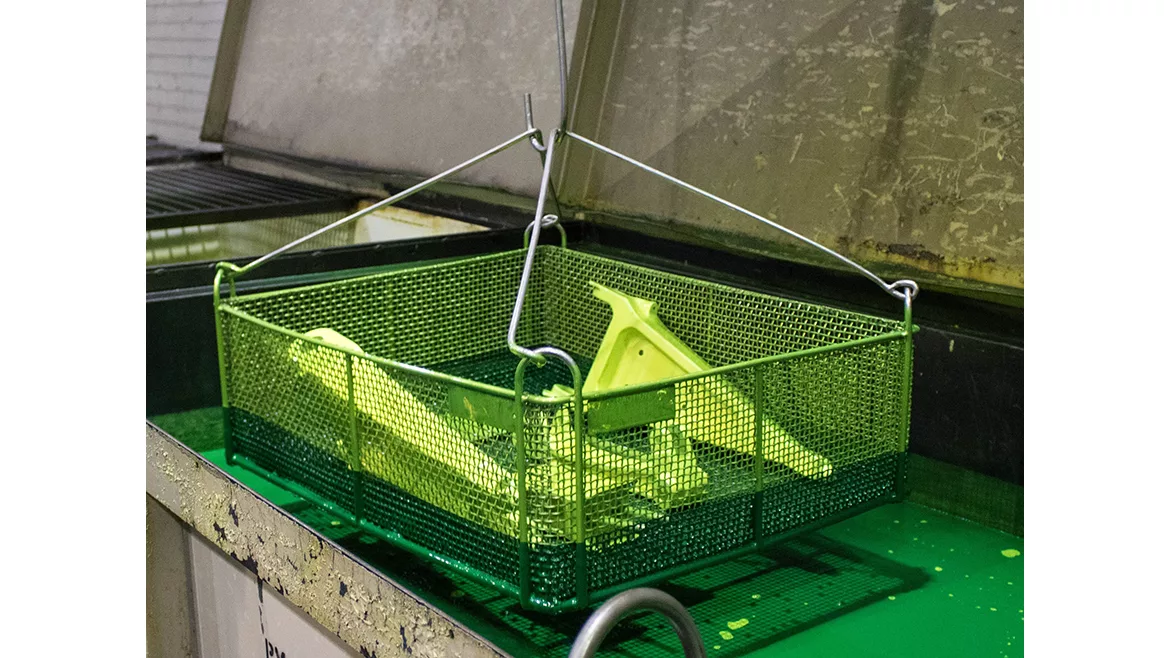

Penetrant testing inspection equipment
Penetrant testing inspection equipment should be engineered specifically for critical part testing applications which require equipment that is easy to operate, durable for years of high-volume use and offers outstanding repeatability. Image Source: Magnaflux
