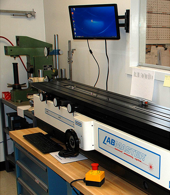

Figure 1: Dorsey Metrology International’s Calibration Laboratory where inspections and calibrations are performed in a climate-controlled environment.

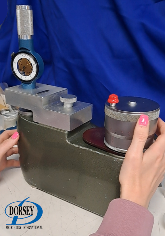

Bore Gage Calibration Dorsey Metrology
Figure 2: Bore Gage Calibration at Dorsey Metrology International Image courtesy of Dorsey Metrology International
The initial step in effective tool calibration is establishing the correct testing environment to account for the thermal expansion of the materials. An independent testing system that regulates temperature and humidity is crucial for successful calibration.
Once the environment is set, conduct calibration tests multiple times and document the results to ensure accuracy. After several rounds of testing and recording, you may need to adjust the instrument or consider sending it to a calibration service if necessary. Be sure to test again and log results following any final adjustments.
