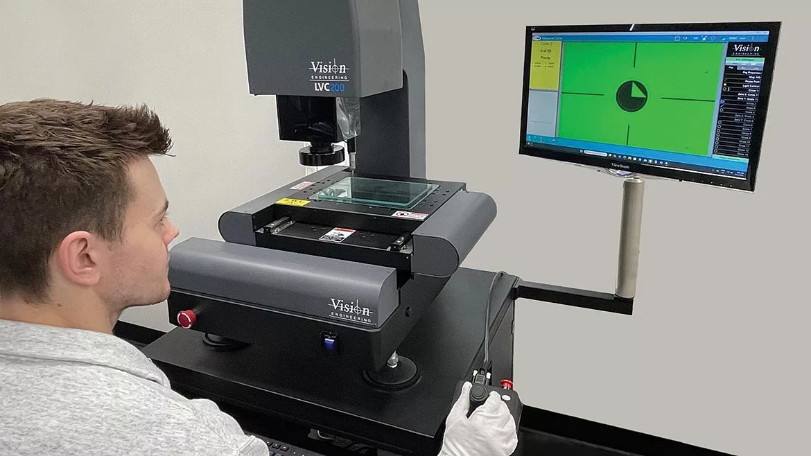

Technician working with the Vision Engineering LVC200.

Verification is checking the accuracy of the machine. Some people refer to it as calibration, but it is not. A verification check ensures that the measuring equipment meets the required customer’s accuracy specification, which is usually the same as the manufacturer’s. Some smaller companies issue a calibration certificate after a verification check, confusing some people and making them think they got a deal. However, the equipment has not been checked against the manufacturer’s specifications in most cases, and regular maintenance checks were not performed.
The equipment required to do a verification check is a glass rule for the X & Y axes and a step gage or gage blocks for the Z-axis. Also, special training is not required. If the accuracy verification check shows that the machine is not measuring within the factory specification, a trained and certified calibration technician must perform an on-site calibration.
