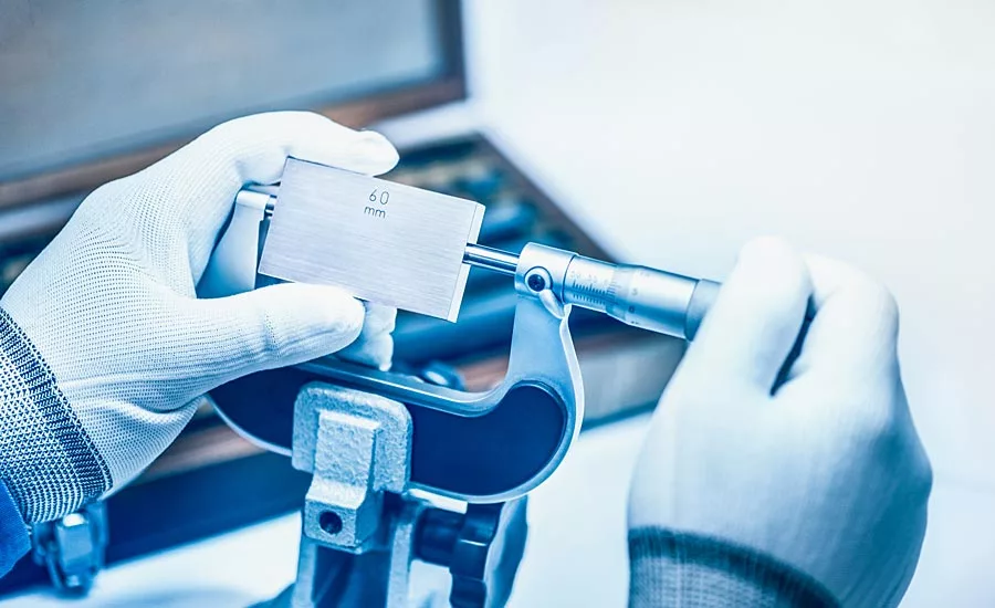

Whether you’re doing internal calibrations or outsourcing it, it’s important to understand calibration basics. This can mean the difference between a company that runs smoothly—or scrambles to get by.

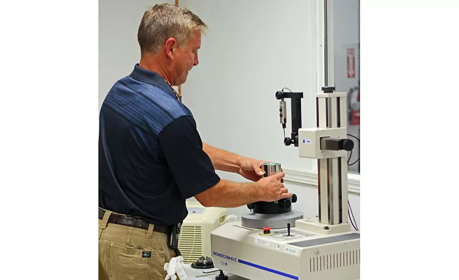

For many manufacturers, finding equipment is a huge problem. If you’re like the customers for Fox Valley Metrology, this is your number-one hassle, according to a company survey, says Steve Toll, vice president – sales at Fox Valley Metrology.
The lowly pin gage, at under an inch wide and two inches tall, is one such item that can be difficult to track. “It’s pretty easy for it to get lost,” Toll says. “Keeping a well maintained database allows them to stay on top of calibrations, due dates, audit times, and quality issues.”
The Fox Valley Metrology survey found that other hassles involved tracking due dates, data entry, and staying on top of calibrations.
“It really just boils down to staying on top of the database,” Toll says. “It’s hard to stay on top of your equipment if you don’t even know what equipment you have.”
Though it can be a cumbersome process, it’s important to keep track of equipment and make sure things don’t get lost along the way.
