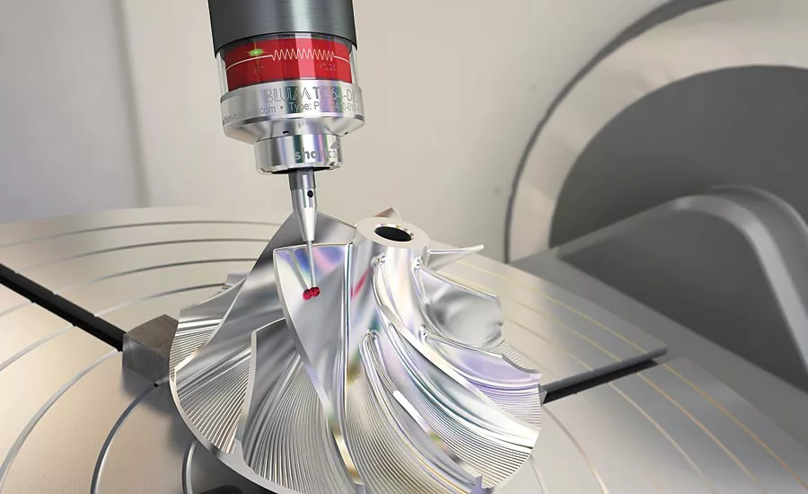

Today we see a trend where more companies are looking for ways they can run lights-out with fewer workers. In-process gaging can help with the automation that many shops need. Source: BLUM

In-process gaging can be performed on any type of machine tool. Source: BLUM
