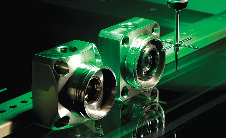

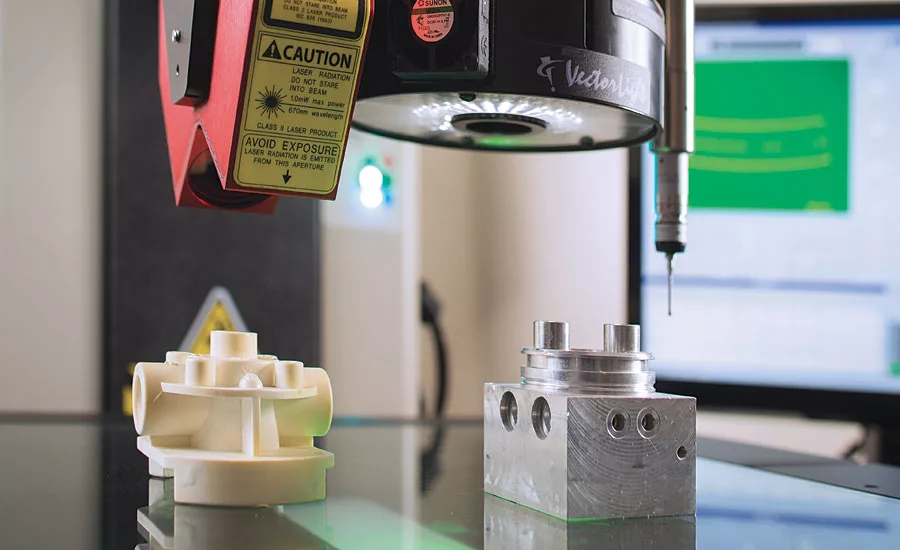

Multisensor measurement machines are highly versatile. This combination of sensors—laser (right), video (center) and trigger probe (left)—are capable of measuring a wide variety of part features. Source: QVI

Touch trigger probes are one of the most common types of tactile measurement sensors. Source: QVI

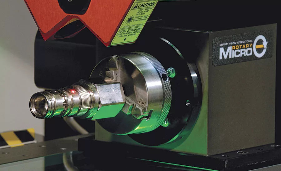

This off-axis laser is just one of many configurations available, based on the specific measurement application. Source: QVI
