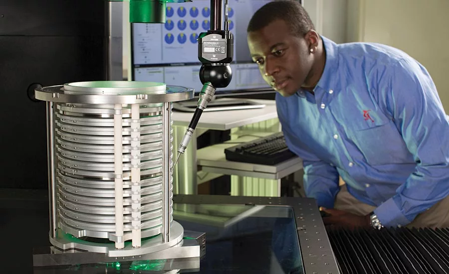

As a contact sensor in a multisensor system sensor mix, an articulating touch probe uses interchangeable styli to access part features that may be inaccessible to other sensors. Source: QVI

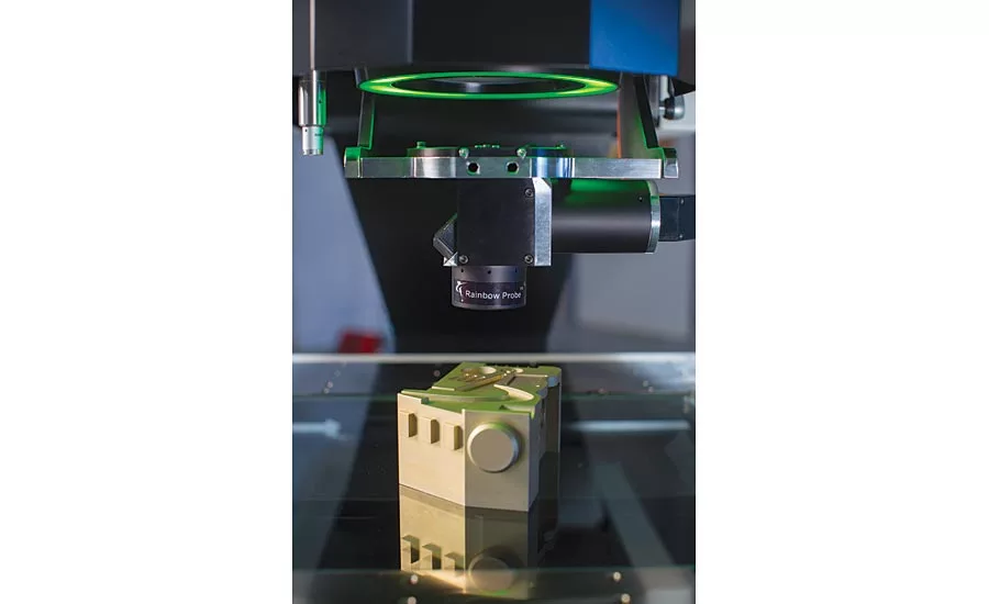

This multisensor system highlights two noncontact co-axial (on a common axis) optical sensor technologies: video measurement of a field of view and a chromatic confocal micro probe for sub-micrometer resolution point measurements. Video measurement identifies features in the camera field of view. The micro probe measures surface points by analyzing changes in the optical spectrum as a function of part-to-probe spacing with resolution. Source: QVI

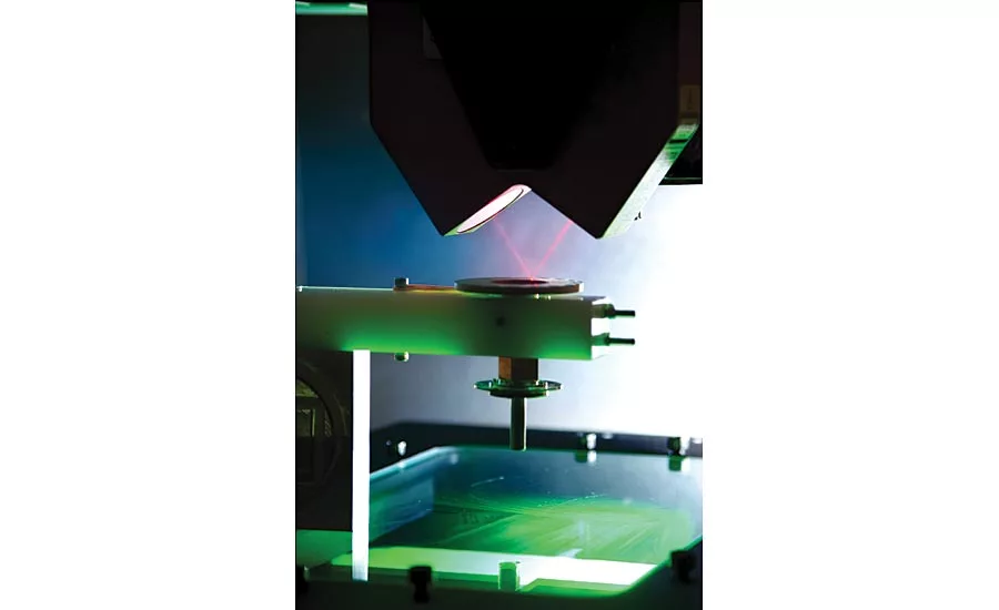

A triangulation laser accurately measures surfaces a point at a time and can be scanned to provide linear and areal measurements of surface details. Source: QVI

Laser – (noncontact sensor) all lasers are not created equal, each configuration is designed to handle different measurement challenges. A triangulation laser, for example, may have difficulty measuring a deep hole, whereas a through-the-lens laser could easily and accurately measure that feature.
Data sampling rate: low (single point) and high (surface scanning).
Speed: high
Accuracy: medium
Optimum feature type: complex and variable surfaces with low reflectivity
Touch – (contact sensor) is the most common type of sensor on a CMM. There are many types and styles of touch probes, each suited for general measurement use, or specifically configured for hard to reach part features. A scanning probe adds contact contouring capability and collects a medium number of data points, and is driven by metrology software
Data sampling rate: low (single point) to medium (analog scanning)
Speed: slow (single point) to medium (analog scanning)
Accuracy: high
Optimum feature type: sharp, hard surfaces and features that are large enough for a physical probe to touch
Video – (noncontact sensor) optically magnifies the image of a part captured by a camera and converts to a video signal that’s analyzed by electronics and software to determine dimensions of edges and features.
Data sampling rate: high
Speed: high
Accuracy: high
Optimum feature type: defined edges, multiple features of similar geometry
