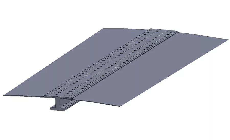

LONGERON FASTENERS AND FAYING SURFACES
Longerons usually carry larger aircraft loads and help transfer skin loads to the internal aircraft structure. Longerons nearly always attach to frames, ribs, or directly to the skin of the aircraft, creating a multilayer aluminum structure. Fatigue and stress cracking eventually appear around the fasteners used to secure the longerons to these structures. Such cracks risk going undetected because they are small (typically 1.25 mm / 0.05 in), they are near / under fastener heads, and often under surface coatings.
Another problem that must be detected and monitored is the corrosion at the faying surface between longerons and the aluminum skin to which they are attached. Faying surfaces are the contact surfaces of two materials placed in tight contact to form a joint. They are used in engineering fastening and joint development of different members to form a strong structure. Faying surfaces usually have a sealant between them so that there is no remaining gap. To prevent corrosion at the faying surface, primers or sealing agents are used to provide an airtight or moisture-tight joint.
If left unchecked, corrosion at the faying surface creates pitting and produces aluminum oxide and hydroxide that are much more voluminous than the initial aluminum alloy. This higher volume results in out-of-plane deformation of the skin between the fasteners referred to as pillowing, which is highly undesirable and must be caught before it develops.
