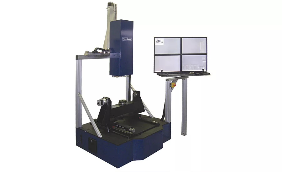

Certain digital optical measuring systems have been developed to overcome these limitations for inspecting IGT parts. With work envelopes of 24” x 24” x 24” (X,Y,Z), even very large IGT parts can be inspected. And with five axes of motion (X, Y, Z, Rotary, Tilt) these systems can properly view parts from all sides and angles. In addition, these optical measuring systems offer two rotary axes, setup in a heavy-duty trunnion configuration that can support parts and fixtures weighing hundreds of pounds. As an option, a larger heavy-duty chuck is available to properly support large and heavy parts. Various mounting systems are also available to allow parts to go directly from machining to the inspection system without re-fixturing. This makes the inspection operation quick and easy, minimizing any stack-up error.
With its 0.25-micron scales and 0.00015” (approximately 4 micron) optical accuracy, this type of digital optical comparator is capable of meeting the tightest requirements and is calibrated along all five axes and throughout the entire working envelope using specially-designed traceable artifacts.
These optical measurement systems are suited to handle large parts with complex 5-axis geometries with an extended depth of field (1.77”, 45 mm), so that everything is fully in focus regardless of the part’s geometry (even in areas of very high curvature). A very long working distance (17.71”, 450 mm) also ensures clearance between the part and the entire optical system to comfortably accommodate large and unusually-shaped parts, which provides maximum flexibility.
This type of optical comparator produces sharp, clear and ultra-high resolution images that present fine details with great clarity and an ultra-bright all-LED computer-controlled multi-angle and multi-quadrant illumination.

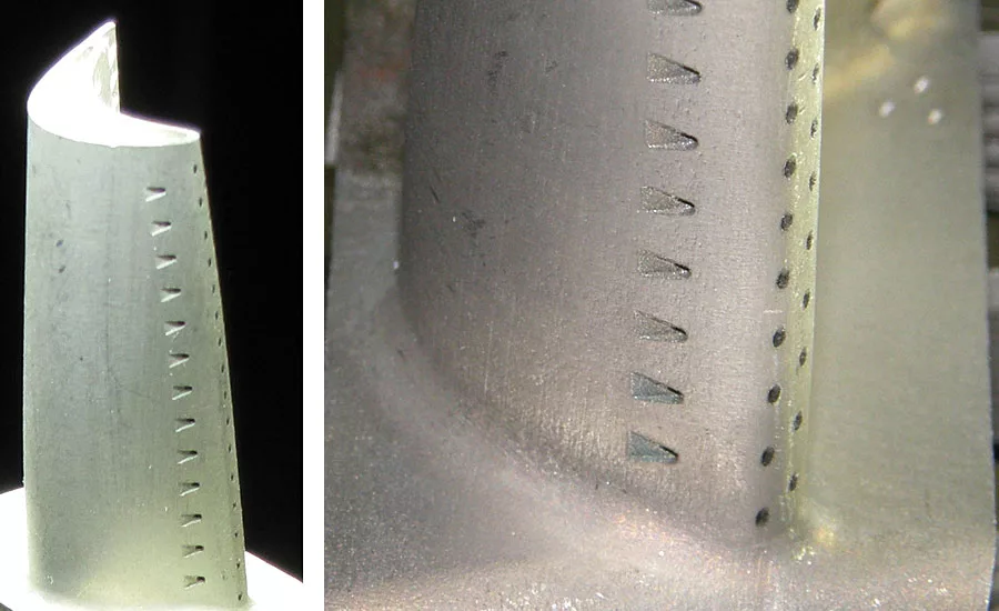

Cooling holes and seal slots are common applications, principally because these critical features have historically been so difficult to check properly, however, digital optical comparators with full 5-axis capabilities allow the drill file to now be read by inputting the fixture height information and then automatically converting the data.

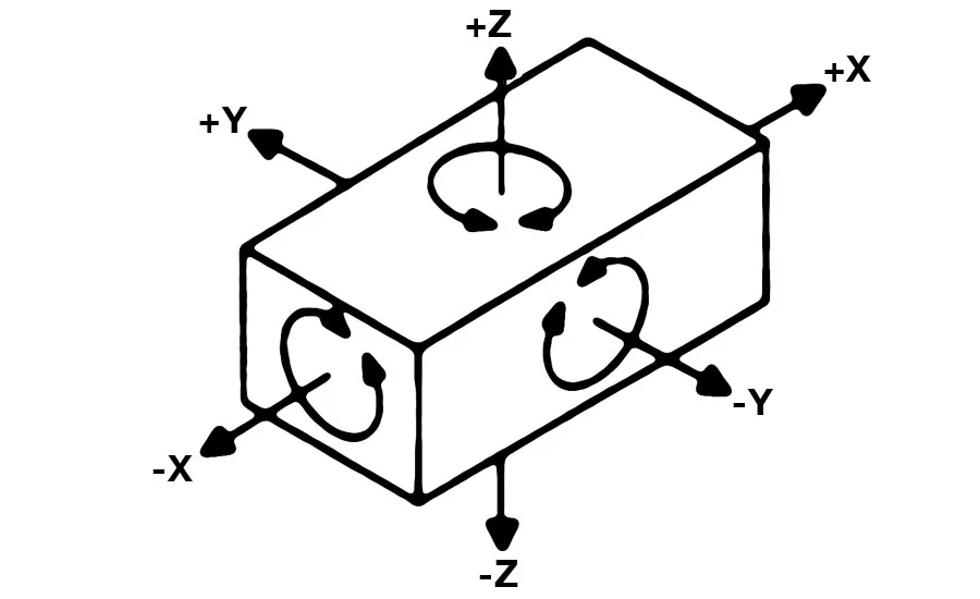

To be able to report the absolute location of a feature (such as cooling holes) on a part, a measurement system needs to know the location of the datums relative to where these locations are expressed. Five-axis parts use a six-point datum structure to set the position along the three Cartesian axes, as well as the rotation about each of these three axes.
There are two different approaches to establish these datums. The first approach consists of using a fixture that physically comes into contact with the six datum points. The fixture is generally designed to easily line up with the un-rotated Cartesian axes (along the fixture’s straight edges for example, or using locator holes, tooling balls or other appropriately-designed simple features), making it simple to “zero out” the five axes of motion (i.e. X, Y, Z, A and B). So with this first approach, the fixture physically sets the location of the datums in space.
With the second approach, a simpler fixture is used to only roughly position the part. With this approach, features on the fixture are still used to “zero out” the five axes of motion, but the resulting coordinate system is only approximate. For every part, the optical comparator still needs to accurately locate the datums and mathematically re-orient the part (in a way analogous to how a physical 6-point fixture reorients the part in space).
A “part reorientation” tool on a digital optical comparator is a powerful and intuitive tool used to carry out 6-point iterative alignment. This tool uses a laser module to accurately locate the part’s surface at the datums, even on parts with complex geometries, and then apply the corrections to part inspection programs. The tool also allows limits to be set on the corrections (to ensure collision-avoidance, for example).
