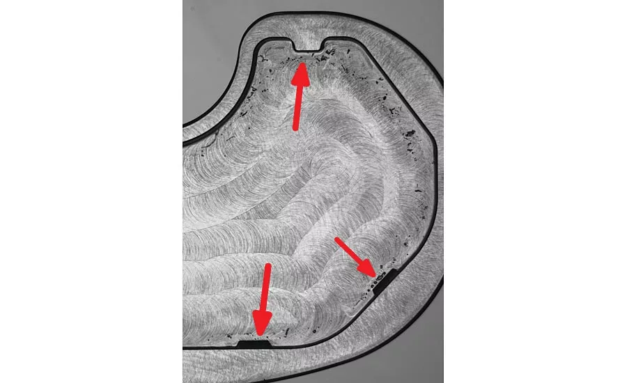

Using specialized adapted illumination, we can clearly see a tibial plate’s critical features (pointed to by the arrows) that hold the plastic/ cartilage in place. These features would be indiscernible using standard illumination. Source: VISIONx

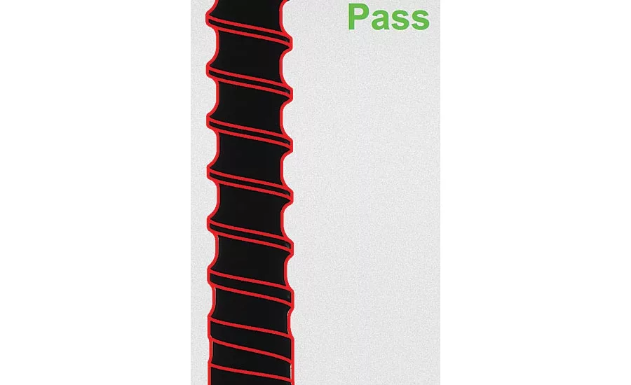

The wide field of depth is perfectly suited to inspecting bone screws at their helix angle. Source: VISIONx

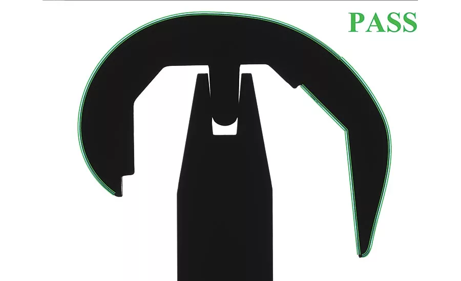

In this image, the system is automatically comparing the condyle (part of a complete knee replacement system) to its CAD data. Source: VISIONx

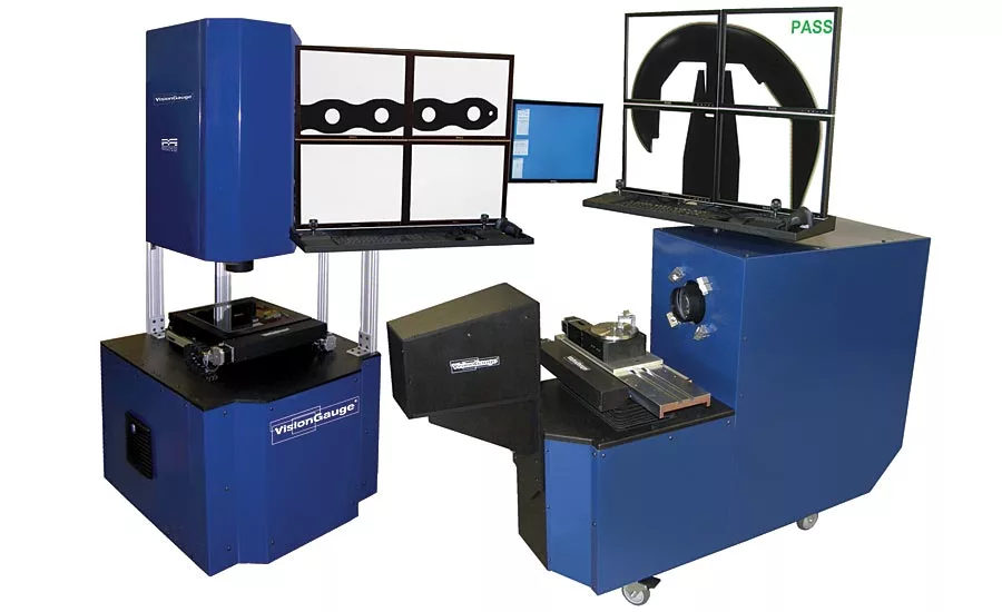

The complexity of inspecting medical devices with digital optical comparators
Modern day digital optical comparators were designed as a solution specifically to overcome the optical/noncontact inspection challenges faced by medical manufacturers. Digital optical comparators are able to produce accuracies down to ±0.0001”, and are available with standard XY travels of 12” X-axis and 6” Y-axis to accommodate the vast majority of medical parts. Extended travels of up to 36” are also available to ensure that all part sizes can be inspected. These systems are not limited to the camera’s field-of-view, but can compare a part to its CAD data across the entire stage travel, enabling even large parts to be checked at high magnification with very fine resolution.
These digital optical comparators are available with various types of adapted illumination to ensure that diverse materials and different surface finishes can be handled effortlessly. The system’s illumination is all computer-controlled to ensure repeatable illumination conditions and is LED-based to provide long life, low heat and low power consumption.
Digital optical comparators are available in both vertical and horizontal configurations to accommodate all geometries. Vertical configurations are perfect for flat parts, as they can simply be laid down on the system’s glass insert. The horizontal configuration has industry-standard dual dovetail grooves that can accommodate existing fixtures for all part geometries. The rugged design is adaptable for use directly on the shop floor.

Digital optical comparators that feature unique CAD Auto-Align and CAD Auto-PASS/FAIL tools consistently produce operator-independent results that eliminate human subjectivity. These tools work directly with the part’s CAD data, in comparison to traditional operator-subjective inspection approaches that required viewing Mylar overlays. These digital optical comparators require no programming, making the system ideal for small lots and quick part changeovers. In addition, they can automatically measure parts, display deviations from nominal and identify out-of-tolerance areas.

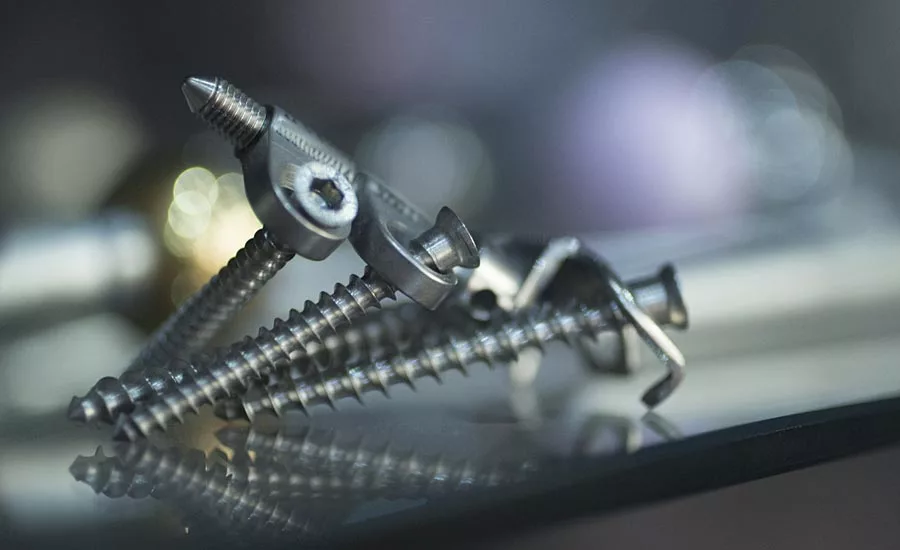

The inspection of bone screws is an exceptionally demanding application. For these parts, many features need to be checked when the screw is at its helix angle. In this position, one end of the screw is closer to the camera and the other is farther away. These two extremes would normally be out of focus on traditional systems. With extended depth-of-field (up to 3”) on the digital optical comparator, everything remains perfectly in focus and the part can be checked in a single step.
