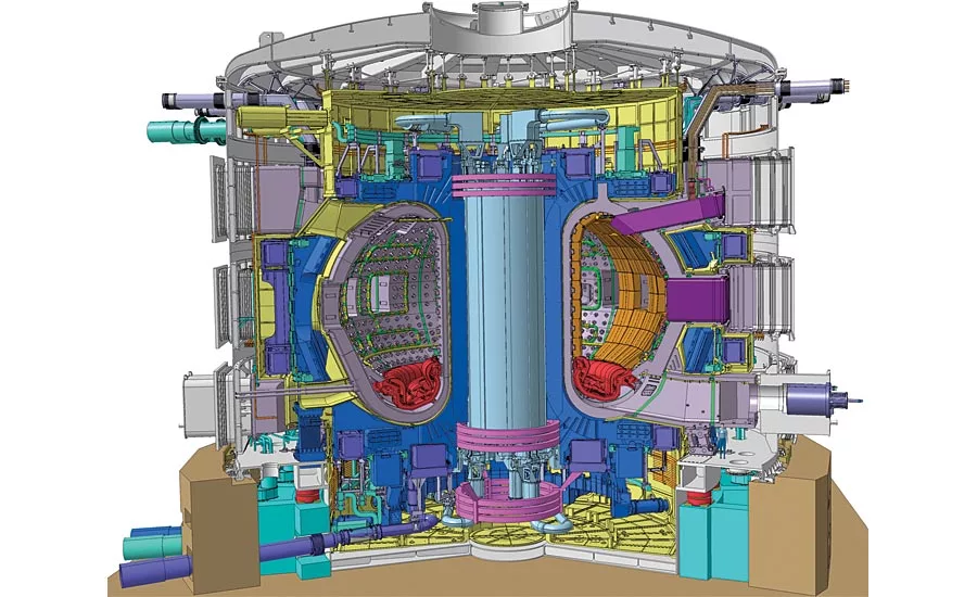

What exactly is a tokamak? The name derives from a Russian acronym for “toroidal chamber with magnetic coils.” The tokamak was developed by Soviet research in the 1960s. It is a doughnut-shaped vacuum chamber that uses the process of fusion to produce energy. This is the same process by which the stars and sun produce heat and light. Hydrogen nuclei collide in the heat and gravity of those bodies, fuse into helium atoms and release tremendous amounts of energy. Within a tokamak, reactions of hydrogen isotopes deuterium and tritium under extreme heat (150,000,000° Celsius, 10 times the temperature of the sun) produce plasma that is maintained at the necessary temperatures and structured by magnetic fields. These fields are a toroidal field generated by external coils surrounding the vessel, a helicoidal field generated by the plasma flow around the torus center and a poloidal field that fixes the position of the plasma flow away from the chamber walls. It is this concept of magnetic confinement that defines the machine as a tokamak.
The plasma flow of a tokamak is used to generate the encircling magnetic field, but it also provides effective initial heating of the plasma. The energy produced through the fusion of atoms is absorbed as heat in the walls of the vessel. A fusion power plant can use this heat to produce steam and then electricity by way of turbines and generators. The energy produced by a tokamak is both clean and safe – there are no carbon emissions and no air pollution, and the tokamak will not explode nor leak dangerous by-products. It can be shut down safely and with far less radioactive waste than a nuclear fission plant. A major goal of the ITER project is to build a tokamak large enough to produce net energy, that is, more energy is produced by the fusion plasma pulse than is required to power the machine’s systems. The ITER tokamak and auxiliary buildings are currently under construction at the Cadarache research center in southern France (Saint-Paul-lès-Durance), with the date to begin fusion operations to be determined.

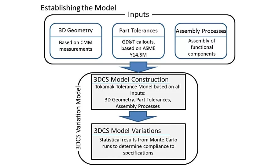

In order to simulate the build of the structure, a variation analysis model was needed. This model used the 3-D Geometry, Part Functional Tolerances and Assembly Procedures as inputs, simulating 3D stack up builds of the product in order to conduct risk mitigation and optimization of the design.
Creating the model was not a small task. The model required a variety of inputs in order to obtain accurate results from the Monte Carlo simulation, the virtual simulation of thousands of projected builds incorporating the model inputs and the resulting statistical analyses. All in all, the final tokamak tolerance model contained:

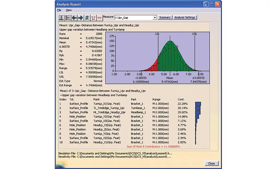

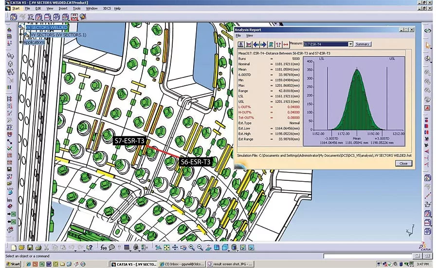

As mentioned previously, a Monte Carlo simulation virtually builds the product hundreds or thousands of times, using a standard distribution of tolerances based on the model inputs and 3-D stack up. After simulating the product builds, the simulation results are statistically analyzed, producing reports that can be used to make determinations about the design.
An example of a simulation, keyed to specific measurement placed on the model between two points, the image on the previous page highlights the kind of information that can be determined. This example shows how, given the current inputs, there will be an estimated 0% of manufactured products out of specification assuming 1,000 products are manufactured. Below the bell curve is the list of all contributing tolerances to this particular measurement, which could be a gap measurement, a flush measurement or a surface measurement, simulating how the product might be measured in a manufacturing plant setting.
By changing the inputs to the model, the results of the Monte Carlo simulation will be changed to account for the updates, allowing design of experiments and iterative studies to reduce the impact of variation.

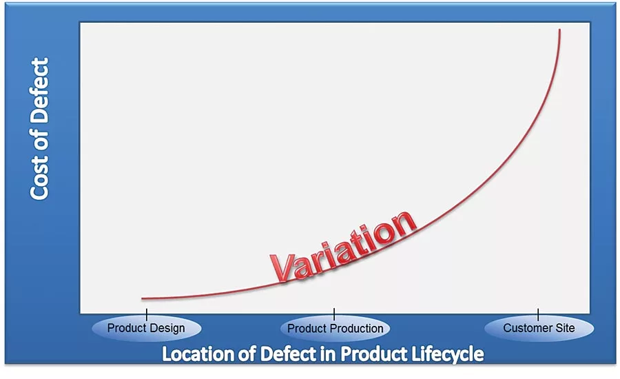

The key element in the simulation of the tokamak is to optimize tolerance requirements and processes before and during construction. The use of simulation studies in the design phase reduces the cost of changes that may be required for optimal functionality and assembly. The cost of defects and variation issues increases exponentially the closer to deployment. By simulating and making alterations to account for variation early in the design phase, overall quality costs can be reduced for the project as a whole.
