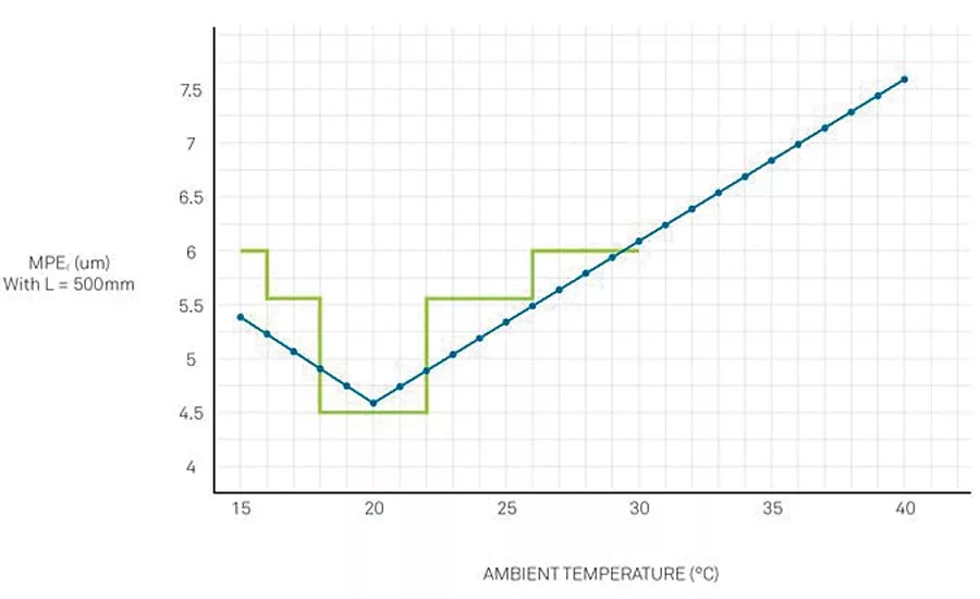

With a measuring length L of 500 mm, the MPEE is portrayed graphically as a step function of ambient temperature.
Continuous Thermal Specifications
Considering the physics involved when metrology frames expand, contract and distort with changes in temperature, we intuitively know that this type of step function is inaccurate. Metrology structures do not normally exhibit changes in accuracy as a step function of temperature, with instantaneous degradations in accuracy occurring when the temperature crosses some threshold value. Or, if they did exist, we probably would not want to make measurements with them.
Clearly, a more detailed description of CMM accuracy under varying ambient temperature conditions is needed in environments that lack sufficient thermal controls. A more physically realistic alternative is the specification of accuracy as a continuous function of ambient temperature. And from the pragmatic viewpoint of the metrologist or quality engineer, it is eminently more useful.
To illustrate the point, let’s take a look at an actual CMM. Consider the accuracy statement of the 4.5.4 shop floor (SF) CMM:
MPEE = 3.1 + 0.05 * ∆T +
(3.0 + 0.2 * ∆T) * L / 1000 (15-40°C)
Where ∆T is the departure of ambient temperature from 20°C
Again, consider a measuring length of 500 mm and plot MPEE as a function of ambient temperature. This time we find a more physically intuitive result and one that is much more useful to the metrology practitioner.
The usefulness of the departure of ambient temperature is further demonstrated when displayed on the same graph of the previous hypothetical example where performance was specified over a series of broad thermal ranges.

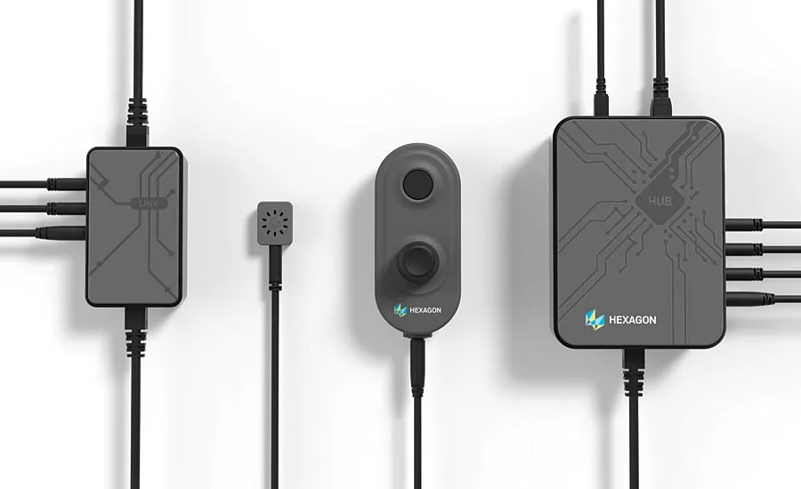

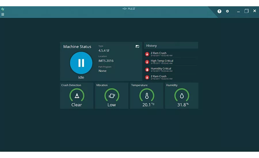

Over the last five years, there has been a shift in the way CMM manufacturers design shop floor systems. Today, engineers are looking at new ways that can turn what was once a reactive system to a proactive and ultimately, more predictive system. The development of CMM monitoring software that continuously measures the temperature, humidity, and vibrations, offers the next generation of data-driven, predictive technology that improves the performance and accuracy of a CMM.
Furthermore, this technology can also capture the movement of the machine by monitoring the CMM’s Z-column forces using an accelerometer, and when a large disruption occurs, it can report and record a crash. How this starts to become a proactive environment is now CMM manufacturers can inform the user of the severity of that crash, and even notify if service is required.
As instances occur, these monitoring systems can immediately inform you via a short message service or an email within minutes of the occurrence. The ability to monitor the environment of the machine, in real time, and be aware of any disturbance creates the foundation for a proactive manufacturing system. By incorporating these kinds of systems into shop floor production plans, manufacturers can take their production to the next level of speed and productivity.
