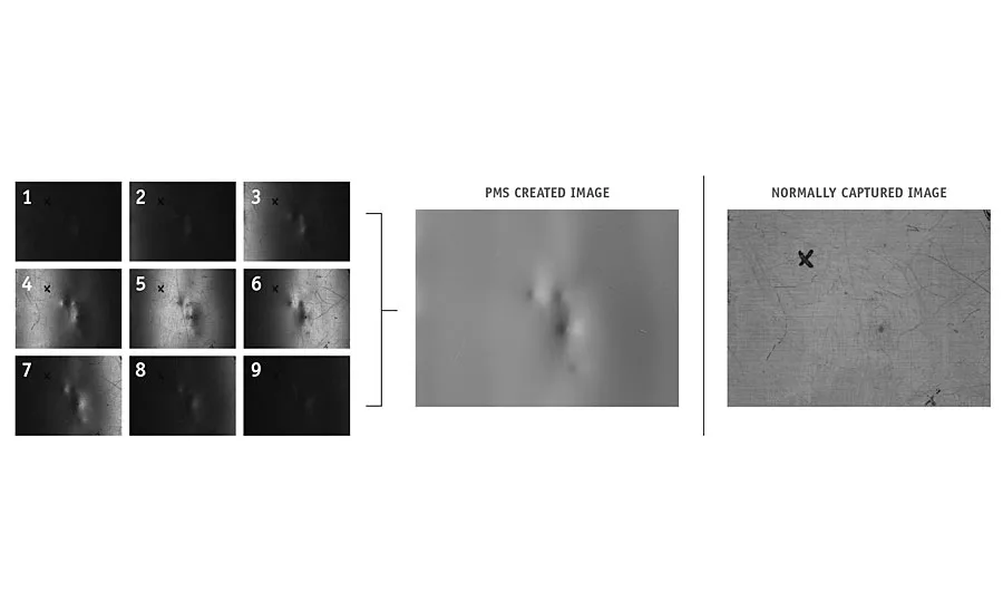

The images in this example were captured with a linear array of nine bar lights. The lights are fired from left to right in sequence to create a “sweeping effect” as the light passes over the imaging area in the center. A surface map can be created from the shading information. In the PMS image, the mild warping and dents are clearly visible and easy to detect. In the normally captured visual image of the same area, the same defects are difficult to detect amid the surface scratches and markings. The PMS routine removes the visual noise and leaves only the features of interest. Images courtesy of Visco Technologies Inc.

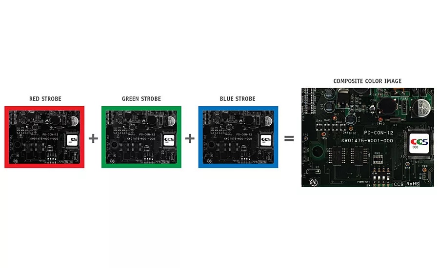

Three monochrome full resolution images are captured. To get the color information, each image is strobed with a single color: red, green, or blue. A color image with the full resolution of the monochrome camera can be created from the data of the three input images. In this example, three monochrome 8-bit 1600 x 1200 images are combined to make a 24-bit color 1600 x 1200 image.

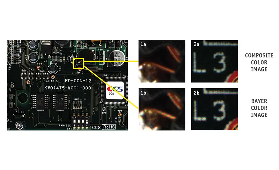

The advantages of this method to create composite color images become apparent as you zoom into feature details, as you might in a machine vision inspection.
In the zoomed image 1a, you can see the two exposed layers of the coil wire and the exit wire to the solder point. The edges are sharp and transitions are smooth with good contrast. In image 1b, the Bayer interpolation artifacts cause the wire to alias red + green along its length. Contrast to the background and between wire layers is reduced and noisy.
You can see similar effects in the 2a + 2b zoomed images. In the Bayer image 2b, the white silkscreen is almost completely Bayer noise. The red/gold/black boundaries of the test point in the lower corner become blurred and wider. In the 2a equivalent image, the silkscreen and test point are sharper, with good contrast and color.

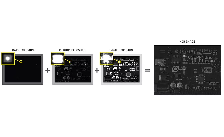

This HDR image is created from three images with different exposures. Image 1 lets you see the LED die and surrounding package, but no other details are visible. Image 2 exposure allows the silkscreen and brightest parts of the components to be seen, but the LED is oversaturated. Image 3 allows the barrel connector and other dark components to be seen, but the text and component leads are oversaturated; the LEDs are completely washed out. The HDR image allows correct exposure of the bright LEDs, proper saturation of the silkscreen and component leads, yet the dark components can still be seen.

Photometric stereo allows the user to separate the shape of an object from its 2D texture. It works by firing segmented light arrays from multiple angles and then processing the resulting shadows in a process called “shape from shading.” It is useful for the detection of small surface defects and 3D surface reconstruction. PMS is a height driven process which can enhance surface details like scratches, dents, pin holes, raised printing, or engraved characters. Because the final image is a computed surface based on the shading information surface coloring or features without height are removed. This can make visually noisy or highly reflective surfaces easier to inspect. This capability is rapidly becoming popular in the machine vision market. Numerous machine vision suppliers are offering photometric stereo tools.

Using a monochrome camera with a CCS full-color ring light, which has three-channel control of red, green, and blue output, the user can generate full resolution RGB color images at practical data rates. By grabbing a sequence of three monochrome images correlated to red, green, and blue strobes, a full color composite image at the full monochrome resolution can be created by aligning the images and using the red, green and blue values for each pixel to create the color pixel. The resulting composite color images are much sharper than that of a single image capture with a Bayer or mosaic color camera. The images are similar to those from three-CCD cameras without the expense, special prism or lens limitations, and at much higher resolutions than that of available three-CCD cameras.
The advantage of this method is the ability to have the best of both worlds: complete color information at the full pixel resolution of the imager. Due to the spatial effects of interpolation, Bayer color imagers capture the color information, but lose spatial resolution across several pixels.

All imagers have a limit to the ratio of the brightest object to the darkest object that can be distinguished in a single image. This is called the dynamic range. Many machine vision applications involve bright, shiny, or dark objects that challenge the dynamic range of the camera. To solve these cases, a series of images with different exposure level can be captured to create a single HDR image with all the detail that needs to be included for the inspection.
