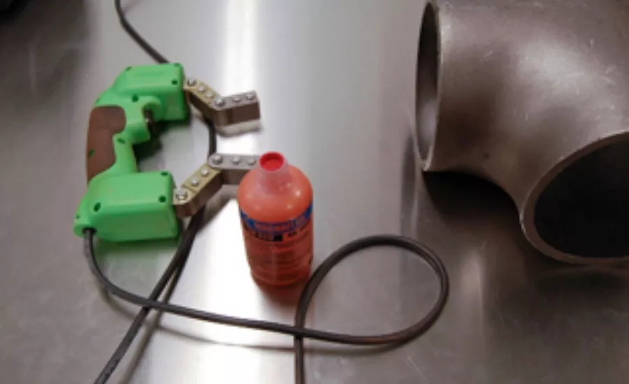

Magnetic particle yoke with dry method magnetic particles.

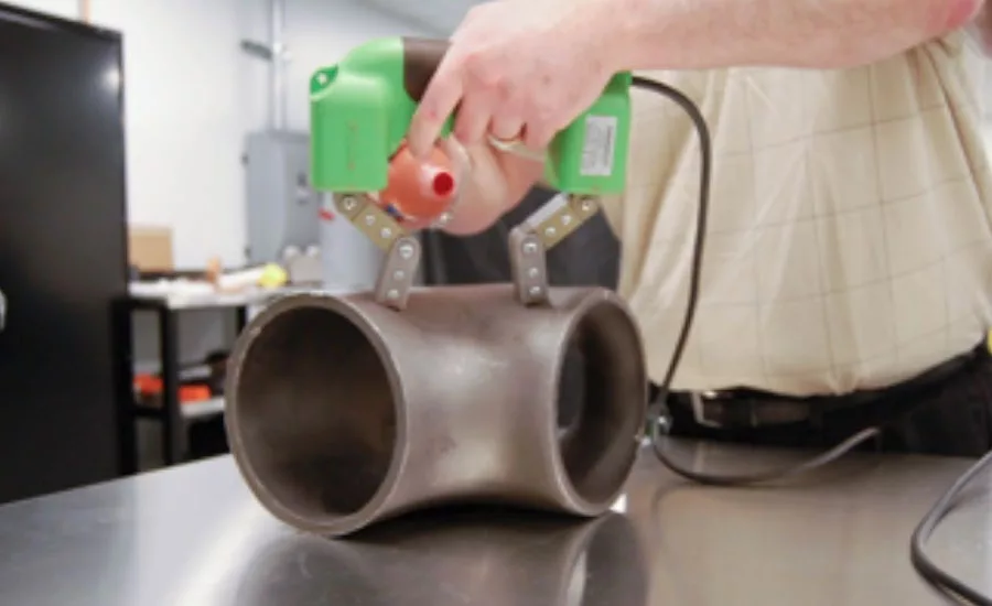

Magnetic particle inspection using an AC magnetic yoke and dry method magnetic particles.

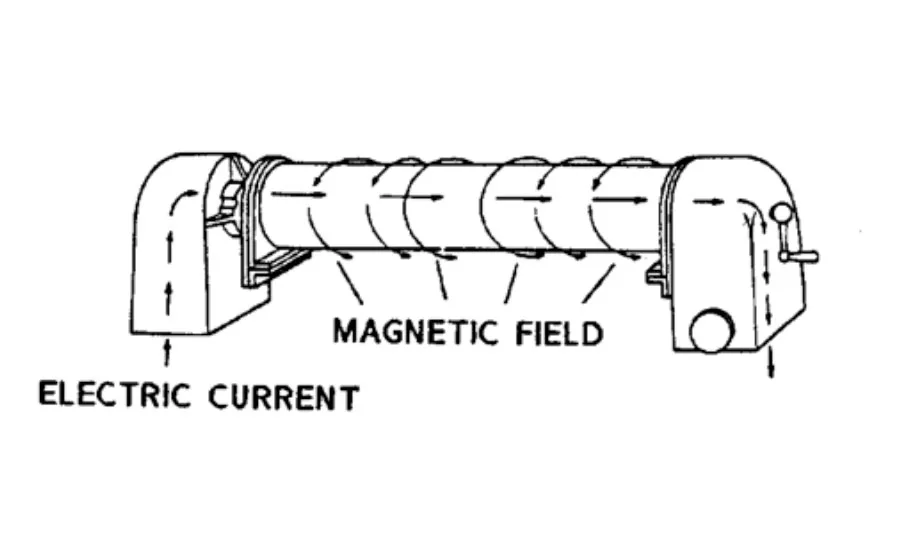

circular magnetization
To locate lengthwise indications, circular magnetization is induced in a part by passing electric current through the part or through a central conductor.

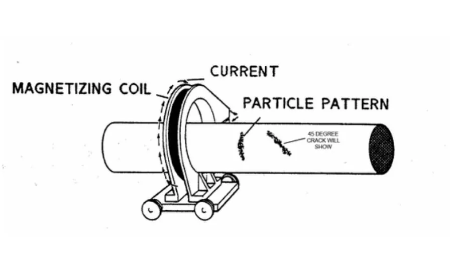

longitudinal magnetization
To locate traverse indications, longitudinal magnetization is induced in a part by passing electric current through a wire coil wrapped around the part.

Electromagnetic yokes are more convenient than permanent magnets, but function the same way. These devices are most frequently used for field inspection and are electromagnets with articulating legs which transfer magnetizing current into the part or test area they are placed on. When the yoke is energized, the legs create a magnetic field in the part. Yokes can be alternating current (AC) or direct current (DC), with AC magnetization causing slightly more particle mobility whereas DC current offers the ability to detect indications slightly under the surface of the metal. When using mag particle yokes, magnetization in two perpendicular axes is needed to thoroughly inspect a part. It is also necessary to “walk” the yoke along a part, magnetizing and inspecting the area between the legs, before moving to the next area.

Any conductor that carries a current also has a magnetic field around the conductor, and the “Right Hand Rule” is the easiest way to visualize the field. When a part is clamped between a headstock and tailstock on a wet mag particle machine, the part becomes a conductor. If you point your right thumb in the direction of current flow, your fingers represent the lines of force. When a discontinuity intersects your fingers it also intersects the lines of force, and will attract magnetic particles. Parts ranging in size from small fasteners to large valve bodies are tested using this method, but large parts such as valve bodies weighing thousands of pounds are tested using large power packs rather than wet benches. Just as with yoke inspection, it is usually required that the magnetic field be turned ninety degrees to detect discontinuities in all orientations.
Turning the field is accomplished by wrapping a coil around the part, and the coil is generally three to five turns. The “Right Hand Rule” applies with coil inspection just as it does with contacts, but a longitudinal field is induced with a coil. Longitudinal fields exit parts and can be measured, which is why coil inspection is usually performed after head inspection.

Magnetic particle powders are available either as dry powder or as particles that can be suspended in a liquid bath. Dry powder is most often used under visible light and is chosen when it is not possible to darken the area or where wet materials are inconvenient. Dry particle powder is frequently blown onto parts using a powder bulb.
