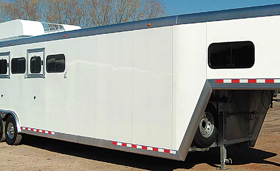

Bonding tape effectively adheres a design element to a panel, such as the exterior sidewall of a trailer. Photo courtesy 3M

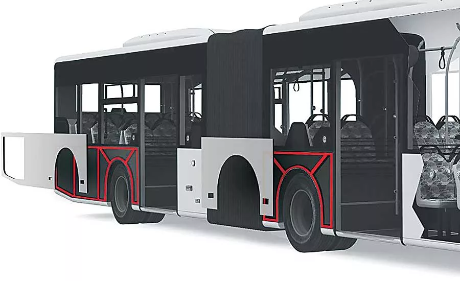

Bus manufacturers sometimes use tape to bond side metal skin panels to the vehicle frame. Photo courtesy 3M

High-strength bonding tape is great at joining panels to frames. Bus manufacturers sometimes use tape to bond the outer roof and side metal skin to the vehicle frame. The benefits of this approach are speed and ease of attachment, instant holding, and the durability to withstand dynamic stress such as wind and weather.
Bonding tape is equally effective at adhering a stiffener, external element or structural glazing to a panel, such as the exterior sidewall of a trailer. Besides speed and ease of use, this approach avoids read-through. The tape foam also reduces vibration and noise caused by flexing of the thin-gauge panel material, such as a commercial baseboard air conditioning unit.
