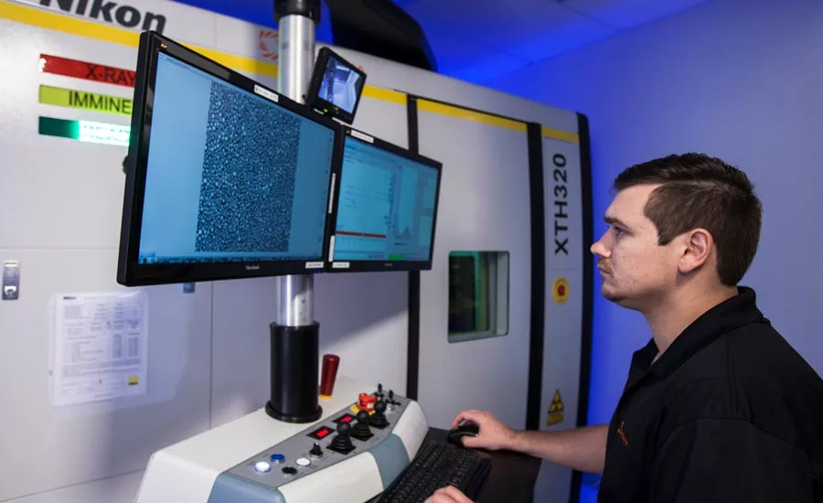

Metal powder for additive manufacturing being inspected
Metal powder for additive manufacturing being inspected using Nikon Metrology micro CT scanner at Sintavia

Additionally, CT allows the source powder to be evaluated before AM even starts, minimizing the risk of defects occurring in the first place. Individual grains of powder in a few slices taken through a small amount of powder are checked for voids, which can cause the grains to explode when heated, blowing away neighboring grains and leaving a hole in the product.
