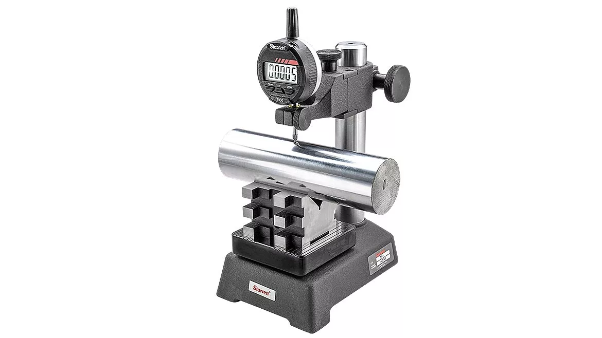

Wireless indicators are equipped to send data with a push of a button and feature IP67 protection against coolant, dirt, chips, water and dust found in harsh environments. Image courtesy of The L.S. Starrett Company (Click on the image to enlarge.)

State-of-the-art, highly accurate digital indicators that meet today’s demanding applications are available with selectable resolution choices from .0005/.0001/.00005” and are IP67 rated. Digital indicators allow for data collection with an end node plug in, while the wireless versions can send data with the simple push of a button to a PC, mobile phone, or tablet.
