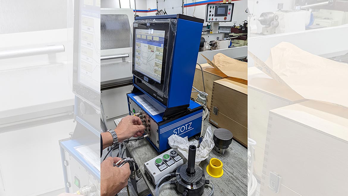

In order to calibrate the gage for the task at hand, a known artifact (MEAN) or artifacts (MIN and MAX) are used to set the display on scale and report accurate and highly repeatable diameter sizes. These artifacts are certified master rings and/or plugs and are typically set at the Nominal or the MIN and MAX ranges of your tolerance. Different manufacturers use different methods of calibration.

Typically, air gaging is used at manufacturing companies that mass produce tight tolerance parts. It is also used to measure complex parts such as tapers even when not in a high production environment because of the ease and speed of which parts can be measured. This technology is used in automotive, aerospace, and medical applications.

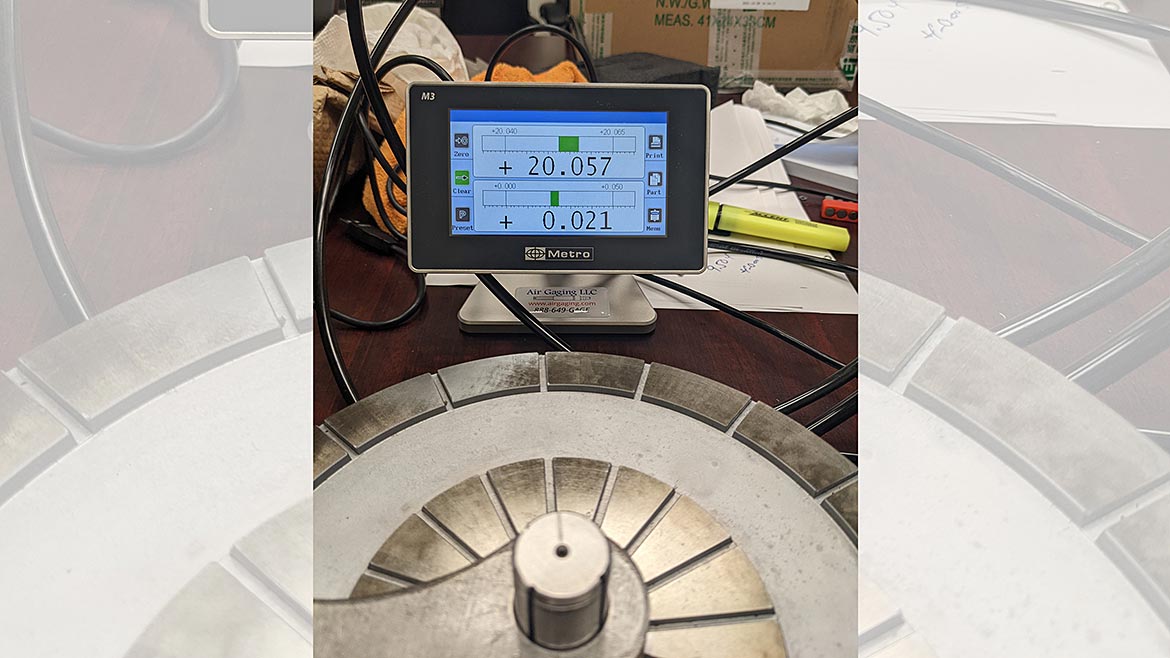

Air gaging is a very fast, efficient and reliable method of measuring. It is designed to be used on workpieces with tolerances of 0.005” or smaller. The resolution and repeatability of the measurement can be in the millionths of an inch. Because air gaging is a noncontact method, it is useful for measuring soft, highly polished, thin walled and other materials susceptible to marking. Air gaging is extremely easy to use and requires no special skills for the operator. Multiple operators will achieve the same or nearly the same measuring results when measuring the same part, thus taking operator technique out of the measurement results. This is a problem when you are using a contact gage such as a micrometer or dial bore gage.
Air gaging can be used to measure complex geometric tolerances such as diameter, taper, parallelism, squareness, flatness and matching of components in a very fast and efficient method.
Many of today’s columns and/or measuring computers can become an integral part of the manufacturing cell with communication to robotic loaders and the ability to send offset values to the machine, which allows for around the clock manufacturing with 100 percent inspection of workpieces.

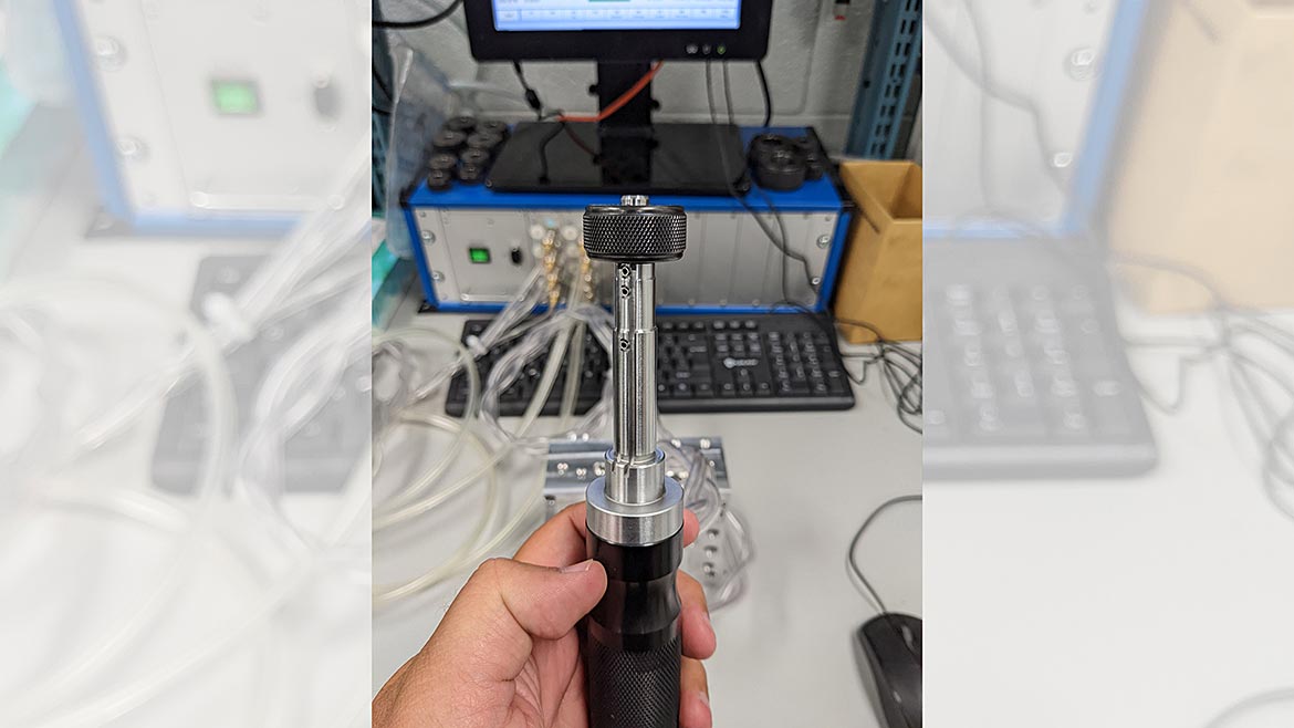

  8. Small diameters. Air gaging can be used to measure extremely small diameters. Less than .6mm on an inside diameter is possible.
  9. Taper measurements. Air is a quick and accurate way to measure tapers. Can display in degrees, minutes, seconds, taper per foot and many more.
  10. Small lands or thin-walled parts. Will not distort the part on thin walls.

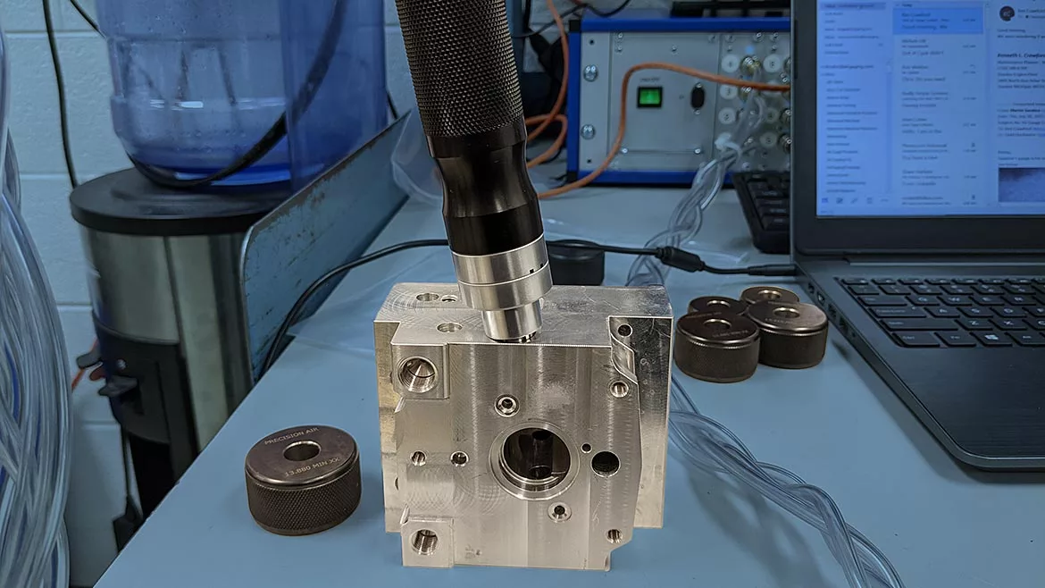

Air gages can be implemented on a work bench on the shop floor for quick first piece or 100% inspection depending on volume. It can also be incorporated into the measurement process with robotic loading for lights out production. They also are commonly used in the gaging lab for verification of parts from the shop floor.
