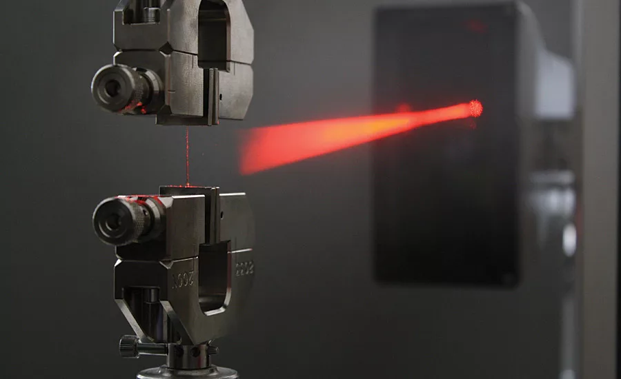

This laser extensometer enables accurate strain measurement during tensile tests. Source: Zwick

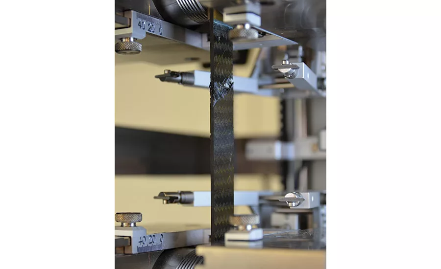

Tensile test demonstrates deformation behavior of a composite specimen. Source: Zwick

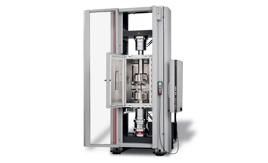

This device contains dual testing areas to reduce changeover time between tensile and other tests on both materials and components. Source: Zwick

The most advanced testing systems must support the high throughput test environment mandated by both materials selection routines and quality management processes for lightweighting initiatives. Rapid test and positioning speeds, coupled with fast return, reduce cycle times for testing. Intelligent features such as recognition of the complete test environment, sophisticated strain-rate control, and online compensation for changes in specimen properties enable lab managers to spend more time focusing on results analysis than test setup.

Fiber-reinforced composites provide high strength and stiffness in combination with low weight. Composites are anisotropic, exhibiting different properties in different directions. They also consist of thin fibers which are either directionally or randomly oriented. Due to their anisotropic nature and wide range of fiber orientations, thorough analysis of composite properties requires that these materials be subjected to a spectrum of tests.
While the typical tensile test does not represent sufficient input for robust characterization of fiber-reinforced composites, the results from a tensile test do support material specifications, qualification and certification of carbon fiber used for the manufacture of such composite materials.
Tensile tests on unidirectionally reinforced materials such as pultruded rods or resin-impregnated fiber tows require a great deal of experience in the selection of a suitable clamping fixture. In many cases the specimen must be protected by tabs to avoid premature fiber breakage in the clamped area. There are, however, solutions which avoid the use of these tabs and the associated extra specimen preparation, delivering efficiency gains in test setup.
Once selection of the proper clamping fixture is complete, the next step is to identify a means of measuring strain. Signal conditioners and electronics for measurements with strain gages, clip-on extensometers and user-friendly damage-resistant mechanical and optical extensometers represent available options for strain measurement.
Measurements on metals and composite materials alike benefit from the use of extensometry solutions that measure up to the point of specimen failure. Extensometry solutions must offer a high degree of robustness in operation. Leading extensometry solutions feature sensor arms that remain on the specimen until after break, providing an optimum means of measuring strain. The sensor arms are applied automatically at the start of the test and move to a safe park position once the test is complete.
