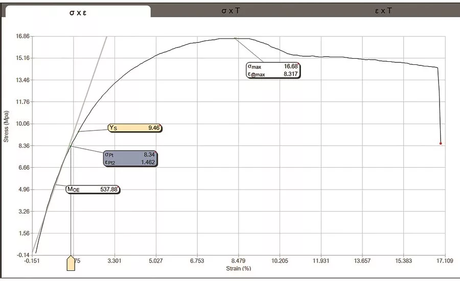

Elastic Limit: The greatest amount of stress the material can have without taking a permanent set.

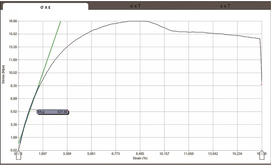

Elastic Modulus
Elastic Modulus: The modulus of elasticity represents the stiffness of the material under test. In tensile applications, this modulus is often called Young’s Modulus and is the relationship between stress and strain within the proportional limit.

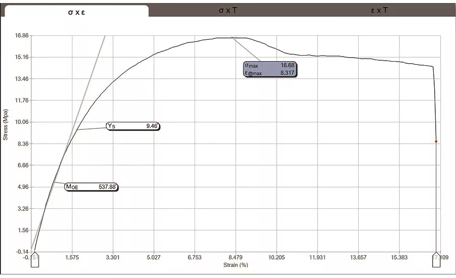

Tensile Strength: The maximum stress observed from the strain-strain curve.

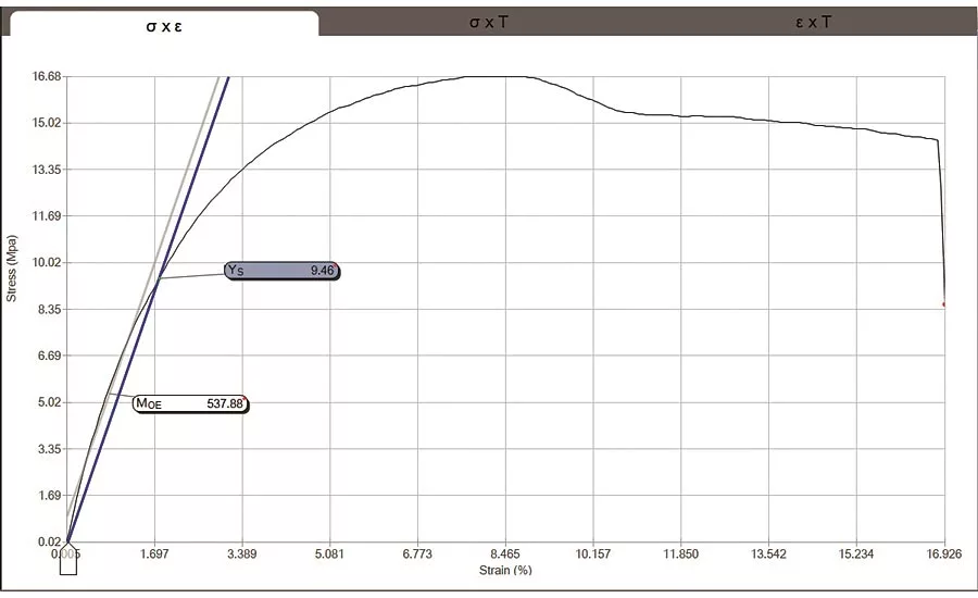

Yield Strength
Yield Strength: Using the offset method, yield strength is the stress at which the material exhibits a limiting permanent set based on an arbitrary 0.0002 in/in strain.

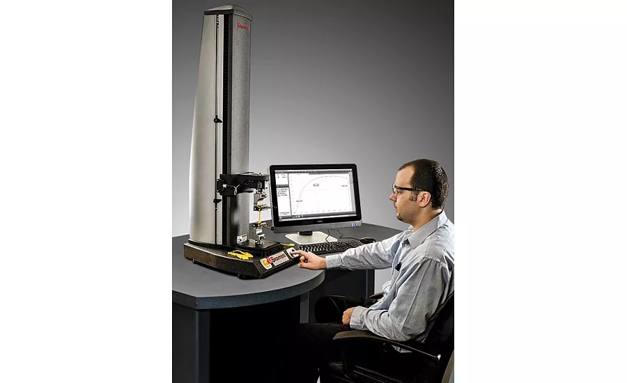

Tensile testing may be performed at a very basic level by simply using a handheld force gage where the gage measures the pull force applied on a sample, product or component in order to determine the maximum force. At the other end of the instrumentation spectrum are extremely sophisticated tensile testing systems equipped with advanced testing software and ancillary instruments, such as extensometers. These testing systems are able to pull the sample under test at a very precise velocity to a very precise target. Large data sampling helps produce high resolution data for both force and distance or stress and strain, so that very accurate measurements can be taken, analyzed and reported.

Tensile strength is the maximum stress measured—often during a destructive test. Stress is the amount of force divided by the original cross-sectional area of the sample under test.

Elastic limit is the highest degree of stress the material can withstand before it exhibits a permanent set.
Yield strength is defined as the stress where the material under test exhibits a permanent set, i.e., the material has gone beyond its elastic limit. Yield strength is often determined using an arbitrary offset value of 0.2% strain from the elastic slope. A line is drawn parallel with the elastic slope line at an offset of 0.2%. Yield strength is where the offset slope line intersects the stress-strain curve.

Modulus of elasticity is the measurement of a material’s stiffness. The more stiffness that is exhibited by a material the less deformation of the material occurs under loading.
