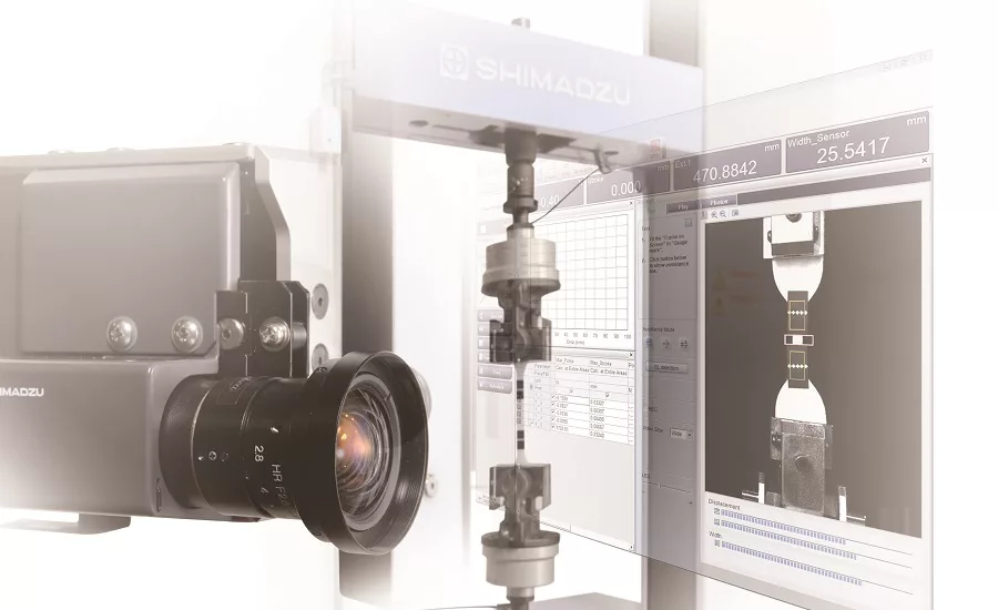

First, the specimen must be fabricated to the correct geometric specification for the material in question, as prescribed by ASTM. Assuming all is correct, the specimen, or “dog bone,” due to its shape, is clamped in the universal testing machine. This procedure requires the right type of grips that grab properly and prevent any slippage. The machine then pulls or stretches the test specimen at a fixed speed. The strain rate of the crosshead, or the testing speed, is again specified by ASTM depending on the material. As the material stretches, an extensometer—or strain gage—measures the deformation within a one-inch separation. A traditional extensometer clamps in the middle of the “dog bone.” There are also non-touch optical extensometers, as well—typically two cameras focused on grids stamped on the test section of the specimen. Regardless of the gage method used, the change in length, divided by the original length, is the strain measurement, or deformation. The strain is then used to calculate the modulus, which is found by dividing the stress—or how much force is required—by the strain.
 “The idea is you want to measure, very carefully, the deformation that is the extension of the material in tension,” Driscoll explains. “And modulus is synonymous with the functional stiffness, or functional rigidity, of the material.”
