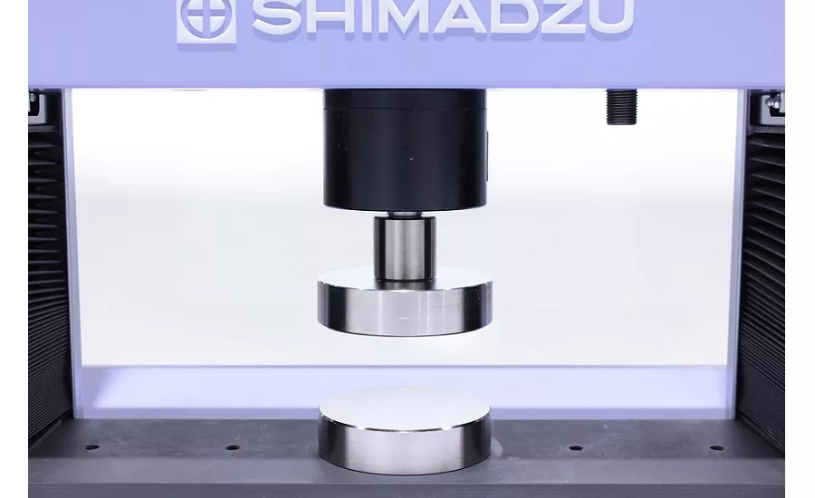

The specimen’s deformation is measured by a strain gage, or a compressometer, that measures the distance between two fixed points on the test specimen during the test, recording the change in distance caused by the load exerted on the specimen.

In compressive testing rigid plastics, a small specimen—usually a prism of 0.5 by 0.5 by 1 inch, or a cylinder with a diameter of 0.5 inch and a length of 1 inch—is placed between two hardened blocks, or plates, in a universal testing machine. Rather than pulling it apart like in a tensile test, the two blocks slowly compress the specimen until the point of fracture or distortion.
ASTM requires that test specimens are conditioned to the appropriate standard before testing, and that the test should take place in a room at the same temperature and humidity as the room used in conditioning. The standard also requires that with isotropic materials, at least five specimens are tested. For anisotropic materials, the standard requires at least 10 specimens, with five tested normally and five tested parallel with the principal axis of anisotropy.
