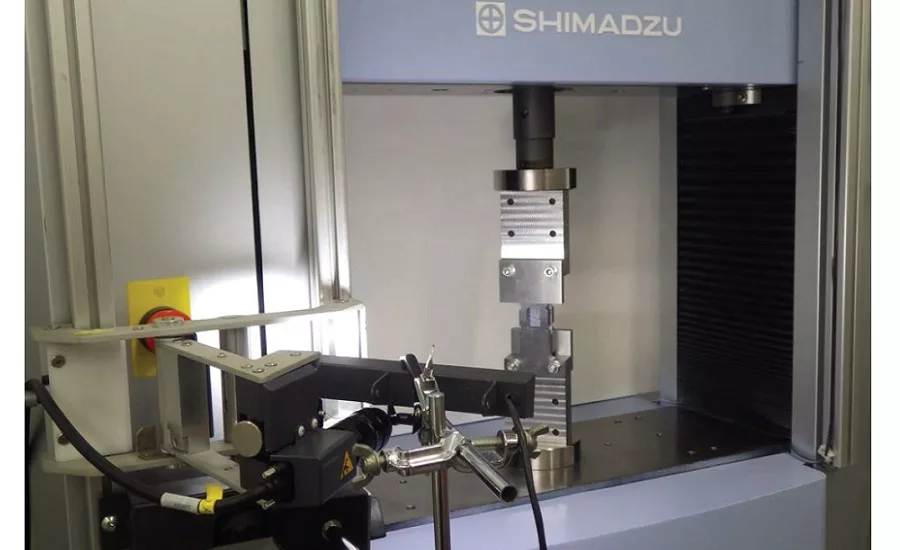

Technicians or engineers making a transition from testing polymers and metals to CFRPs should remember that many tests commonly performed for isotropic materials won’t necessarily completely characterize a material that’s anisotropic, such as a CFRP, says Riley.
“So if you’re testing a material that was presumably isotropic, you could just run a tensile test,” he says. “And if you had it instrumented to the point that you could get your longitudinal and your latitudinal placement of your test specimen, you could theoretically get every single material property—or at least your basic mechanical properties—out of one test. You could get all your moduli, your Poisson's ratio, your shear modulus, your strength.
“But when you’re dealing with CFRPs that are designed to be anisotropic in nature, instead of there being one elastic modulus like there would be in something like a polymer, there are actually a total of three of them. And instead of there being one Poisson’s ratio, there are actually three of them, and instead of there being one shear modulus, there are three of them. There’s a lot more that actually needs to be characterized than there traditionally would in an isotropic material.”
In order to fully characterize a CFRP sample’s properties, a technician or engineer needs to run tests in all three orthogonal axes. To achieve this, multiple test samples can be cut from one large sheet of CFRP laminate, with each sample cut at different angles in relation to the direction of the carbon fiber weave. Each test angle is then repeated at least three times, generally, though the precise requirements are defined by ASTM depending on the test and specific material.
Technicians and engineers should expect CFRPs to behave differently in tests than more traditional materials. Consider a flexural test. With an isotropic polymer, generally speaking, the elastic moduli will often be the same for both bending and stretching.
“But for something that’s anisotropic, like CFRPs, those are actually two different values. There’s going to be a different stiffness of the material in tension. In addition, there are also different failure modes that occur,” explains Riley. “A polymer will typically have the same failure mode in bending as it would in tensile loading. But a CFRP could have multiple modes of failure.”
In tensile testing, the failure mode could be caused by the load pulling carbon fibers out from the polymer matrix, or the test could fracture the fiber. When bending the same CFRP, an often-missed failure mode is called delamination, or when the laminate layers peel apart due to the shear stresses that happen at the surface. It’s a failure mode that would not happen with a pure polymer.
“The main piece of advice that I would give to someone looking to make that transition [from polymers or metals to CFRPs] would be to understand the anisotropic nature of it, and to at least understand the additional complexities that introduces,” Riley says. “Also recognize that it’s not a bad thing. It gives you a lot more capabilities as a designer to actually make the CFRP component suitable for your specific application without over-designing it for other loading scenarios that it might not actually encounter in its operation.”
