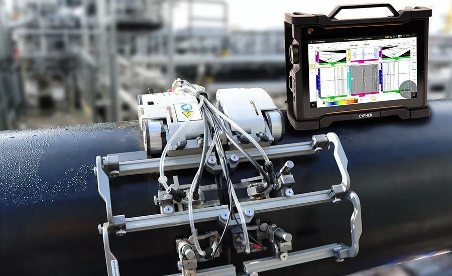

This image displays a Eddyfi Technologies Cypher portable inspection instrument alongside a scanner for non-destructive testing (NDT).

Automation and Digital Workflows: The Role of Cypher
Technology alone is not enough; usability and workflow integration are equally critical. Eddyfi Technologies’ Cypher platform was developed to make advanced ultrasonic inspection accessible, efficient, and consistent—even as inspection techniques become more sophisticated.
A Multi-Modal Ultrasonic Platform
Cypher supports a wide range of ultrasonic modalities within a single system, including PAUT, TOFD, FMC/TFM, PWI, and Pulse Compression Imaging (PCI). Inspectors can run multiple techniques simultaneously in a single pass, maximising data collection while minimising inspection time.
Key features include:
  • Real-time PWI and TFM reconstruction with high signal-to-noise ratio
  • Dual 64-element probe support for enhanced coverage
  • Intuitive software designed with direct input from inspectors and application engineers
Automation with Navic™ 2
When paired with the Navic™ 2 magnetic-wheel crawler, Cypher enables fully automated weld inspections. The crawler allows remote operation in hazardous or difficult-to-access environments, with scan speeds of up to 250 mm/s and precise encoded positioning.
Automation delivers consistent, repeatable results while reducing operator exposure and fatigue—an increasingly important consideration as the industry addresses skills shortages and workforce safety.
