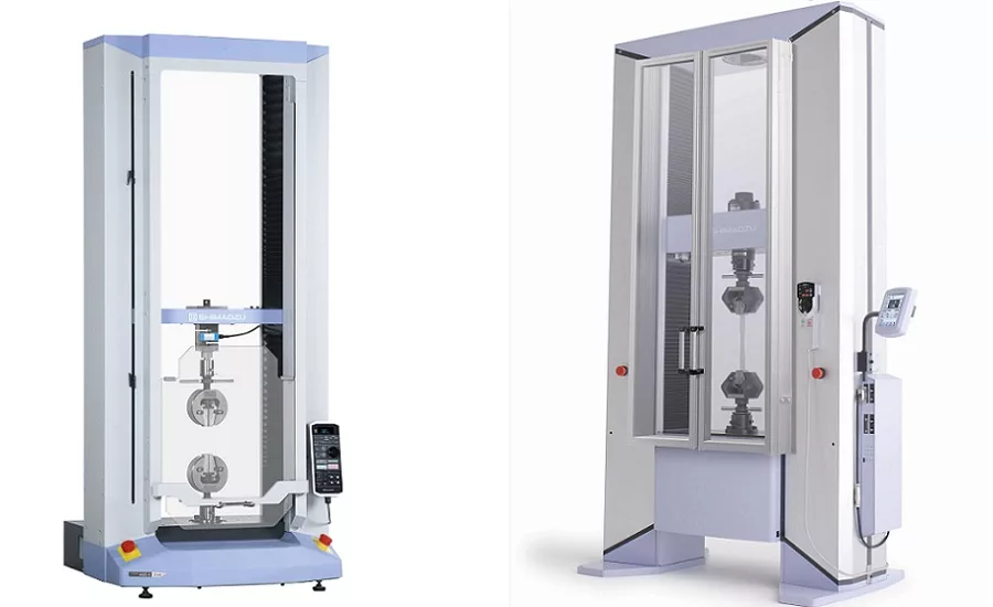

It requires a test force accuracy that meets ASTM E4 Class 1, and accuracy within ±1% of the indicated test force. The standard specifies that tests can be conducted in one of two ways, measuring the crosshead position of the testing machine being used, or by using a deflectometer.
Using the crosshead position is generally for quality control purposes, where obtaining a close approximation of a value is all that’s needed, according to ASTM International Fellow Harry Yohn. For more accurate results, especially for engineering design purposes, a deflectometer is required.
How Does a Basic Flexural Test Work?
A rectangular cross section of the desired testing specimen is rested on two supports, and a force is applied by a loading nose midway between the supports.
“A support span-to-depth ratio of 16:1 is used unless there is reason to suspect that a larger span-to-depth ratio may be required, as may be the case for certain laminated materials,” according to ASTM information provided by Shimadzu. “The specimen is deflected until rupture occurs in the outer surface of the test specimen or until a maximum strain of 5% is reached, whichever occurs first.
“Flexural properties may vary with specimen depth, temperature, atmospheric conditions, and the difference in rate of straining.”
For the most precise results, a deflectometer, or deflection gauge, measures the amount of flexural displacement of a material when a load is applied.
It’s essential that properly calibrated test frames are used that can be operated at constant rates of crosshead motion over the range indicated, according to Shimadzu, and the load cells used are compliant with the test force accuracy required by D790. Lastly, having a variety of three-point bend testing fixtures allows laboratories to test a variety of specimens.
Deflectometers are more accurate that measuring the crosshead, because a crosshead measurement can be influenced by any give or movement throughout the entire machine, according to Yohn.
“A deflectometer contacts with a specimen during a test and measures the actual deflection that the specimen sees, and only that,” he explains. “You don’t have to worry about machine movement, fixture movement, or any other kind of movement. It measures what goes on at the specimen level.”
