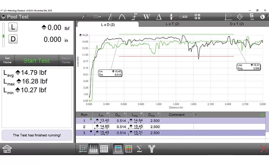

Creating a “tolerance envelope” can help operators quickly identify out-of-tolerance areas in peel or seam testing. The black trace above can be seen dipping below the specified minimum load as represented by the red line. The green trace is shown in tolerance for the specified area. Source: The L.S. Starrett Co.

There are also testing scenarios where individual data points are insufficient. For example, when testing welded or stitched seams and adhesives in a 90 or 180 degree peel test, tolerances may be specified for a maximum allowed load or a minimum allowed load over the length of the seam.
A tolerance envelope will ensure the seal remains in the range, where using individual tolerance points risks an out-of-tolerance point being missed. If the graph trace stays within the envelope, the tolerance lines display green, indicating that the measured results are within the envelope. If the graph trace goes outside the envelope at any point, the tolerance line segment displays red. If the data for the results are outside the high limit, the top line segment will display red. If the data for the result are outside the low limit, the bottom line segment will display red.
