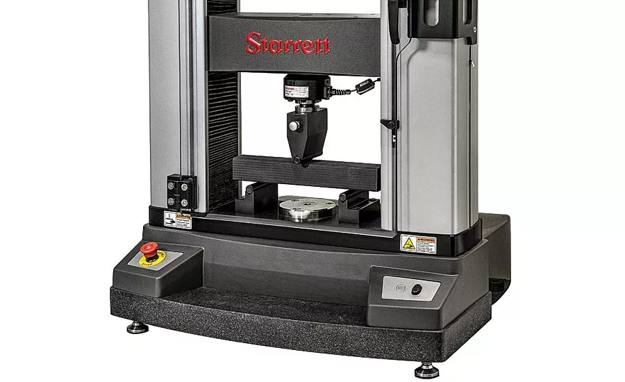

Load cell sensors

Figure 1. A full range of precision load cell sensors are available for material testing, force analysis and force measurement applications.

Today’s force measurement systems have features that help prevent sensor overloads. The majority of sensor overloads are due to operator error. For example, the user caused the overload by not understanding the sensor’s performance, the test method application, or due to simple misuse and neglect. Many systems or instruments provide visual indication of where the measured load is relative to its capacity. Some systems feature load scaling that creates an operating range for the sensor that is within the full-scale range of the sensor. Travel limits on test frames stop crosshead travel and help reduce sensor overloading. However, it is critical that users understand what the full-scale deflection means for the sensor and what the associated travel limitations are. Additionally, with motor-driven systems, it is equally important to understand that a crosshead, moving at a high velocity is incapable of stopping immediately when it comes into contact with a hard object. Finally, low-capacity sensors can overload and become permanently damaged by a user improperly handling the sensor. (See Figure 1.)
