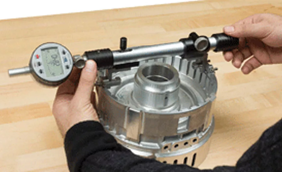

Multimar 844T Measurement Gage
April 1, 2016
The Multimar 844 T Universal Measurement Gage from Mahr Federal takes your large ID and OD gaging to the next level. Built on a finely ground, hard chrome-plated column, and available in a range of sizes, the Multimar 844 T can measure ODs and IDs up to 2500 mm with extreme sensitivity and accuracy. New Multimar 844 T gages now include a number of improved features that make them more precise, more stable, and more flexible than ever.
Improvements to the 844 T include a new precision guideway with ball bearings on the moveable arm to improve reliability and repeatability. New stop elements include 3-point support for tilt measuring motion on the workpiece. New heat isolating handles reduce thermal influences, and the Multimar 844 T now comes with a set of mounting stands to hold the gage when not in use, which helps prevent damage to the gage.
The Multimar 844 T can be fitted with any measuring indicator with an 8 mm mounting shank, including new wireless indicators for easy data collection with no cables. The stationary measuring arm can be moved along the column for coarse adjustment, and constant measuring force is applied due to a built-in measuring force spring. Both the direction of the measuring force and the measuring arms can easily be changed for either external or internal dimensions. Gages larger than 1000 mm (39.75 in.) incorporate a carbon fiber reinforced plastic tube to lighten the gage without losing stability.
These features make the Multimar 844 T a very versatile and flexible instrument. Measuring applications include: IDs and ODs; external and internal thread measurements; centering shoulders, narrow collars, recesses and grooves; external and internal tapers; external and internal gear tooth profiles; and more. Its tubular shape and robust construction also make the 844 T very easy to use.
But what makes the Multimar 844 T so versatile is the wide range of measuring arms, anvils, mounting attachments and depth stops available. Anvils and tips are available in a wide variety of shapes and configurations, including threads, flat and spherical shoulders, blades and round faces.
