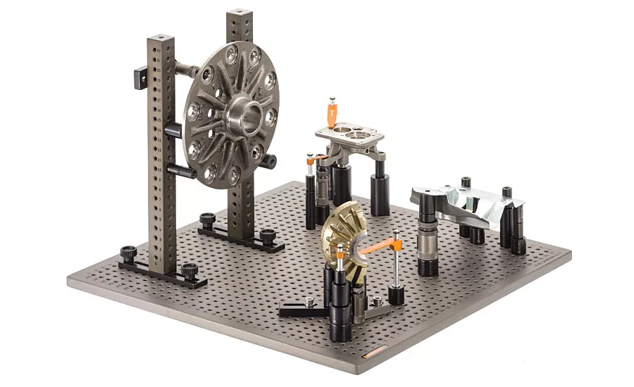

Modular fixtures support a range of components using clamps, towers and magnets. Source: Renishaw

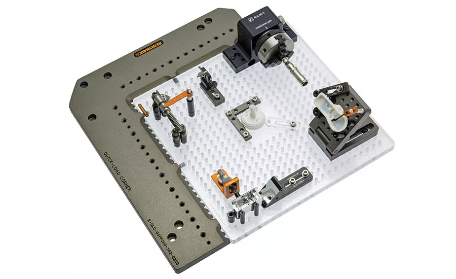

Vision fixtures are purposely designed to inspect small and intricate parts with a range or micro fixturing components as well as clamping solutions. Source: Renishaw

Modular fixtures are capable of fixturing most parts and presenting them in the optimal position to the inspection equipment. They also handle a variety of part materials and shapes. They are designed to fixture the part and provide the flexibility to change over for another part in the future. Base plates are the foundation of every setup and are available in aluminum and clear acrylic, in a range of sizes to suit the application or the dimensions of the CMM, vision or gaging system. Many fixture plates are alphanumerically labelled to help document and record the fixturing setup for future use, and to comply with quality standards. A wide selection of fixturing components is available to help elevate, locate and secure a part into a specified position. Adjustable components are designed to level complex parts or fixture them in a desired position for the most efficient inspection. Further components include clamps, magnets or suction cups, all ideal for securing a part.
Some applications may require multiple modular fixtures to keep setups assembled for faster or recurring inspections. This allows for the flexibility of a quick changeover and can also increase the throughput of the inspection equipment as it is possible to start the inspection as soon as the system becomes available.
