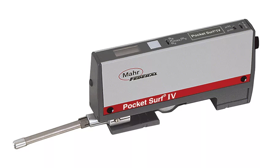

Handheld skidded roughness gages are by far the highest volume surface finish instruments sold. While early models could only measure a few roughness parameters and provided no data output or analysis, today’s instruments offer a range of useful features. The newest models measure some 30 parameters; provide onboard memory, SD cards and USB connectivity; have color touch screens; and can even display roughness profiles.
These portable devices are very handy and easy to use. Let’s say you are a job shop and you’re measuring parts for a customer. They want you to measure roughness on a sample out of each lot that you send them. Maybe your sample is 30 pieces. So you go out, measure your 30 pieces while the instrument stores the data, then come back to your desk and download the data right into a quality report that goes with the parts. No writing down a bunch of numbers and little chance for error.

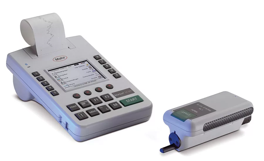

The next step up in roughness gages still offers portability, but provides increased capability by separating the skidded drive unit from the evaluation unit. Costing up to around $7K, these instruments measure more parameters—up to 50 with some models— have more memory, larger displays, and even have built-in printers for profiles and measurement logs. Better models also evaluate things like bearing area curves, MOTIF parameters, and much more. Connectivity between drive and evaluation units is either wireless or via USB cable (cabled drive units are smaller and can typically be mounted in special fixtures), and of course today’s units provide data downloading and export capability, as you would expect.

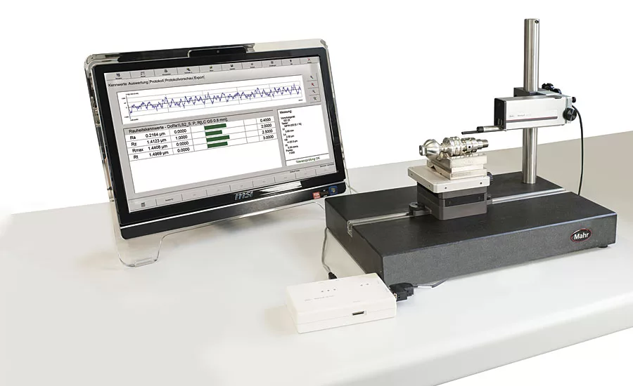

The next step up is to PC-based systems, which add the ability to use PC-based software instead of a dedicated controller box. This gives you the ability to use tools like touch screen software, store profiles, and have custom parameters written for your applications. You can also put these instruments on a network and do SPC data collection.

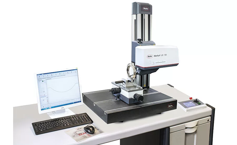

At the high end of skidless instruments, a motion controller is added to the PC-based system and allows you to control motorized measurement stands and drive the column up and down. You can have CNC control of the surface finish unit so you can program it to stop and start at certain places while it measures. This gives you a lot more capability in how you set up and automate your measurements. Typically, these systems can be used with a whole host of drive units, all of different size and complexity.
