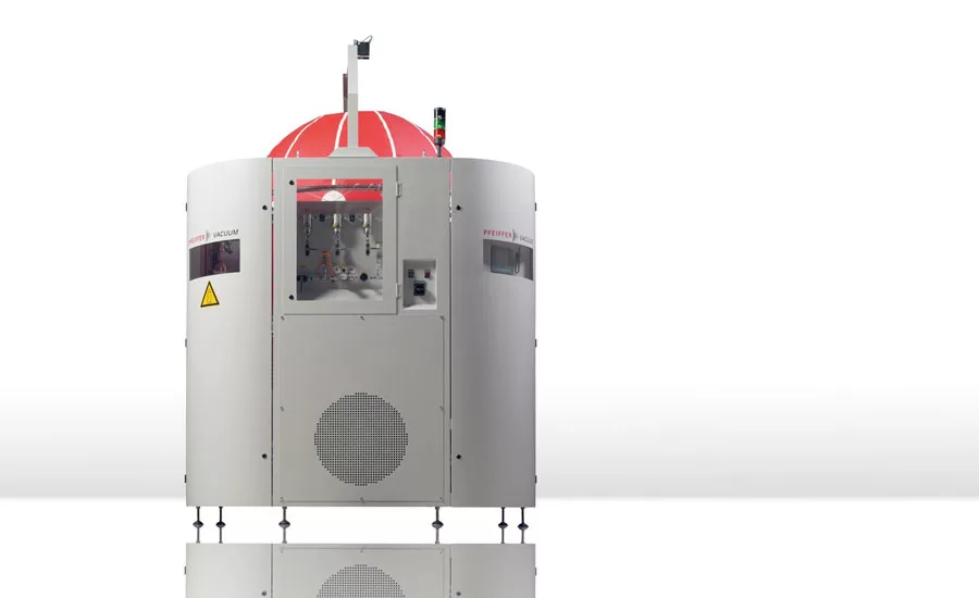

Electronic leak testing can be separated into two major groups: (a) tracer gas leak testing (b) air decay/flow leak testing which can only be used to determine the overall leak rate (global test). The air technique is typically used for less stringent applications, for example, to ensure a small part will not leak a viscous fluid such as water or oil. The air decay/flow test method has many applications in the high volume production automotive market, but far less in the aerospace industry where components tend to be large and where a higher sensitivity is required. As components and assemblies in the aerospace industry are manufactured on a much smaller scale than automotive and therefore more expensive, locating the leak for later repair is essential. To address the sensitivity and leak location requirement for testing in the aerospace industry, the leak test is typically performed using a tracer gas such as helium or diluted hydrogen. The detectors most commonly used are mass spectrometers.

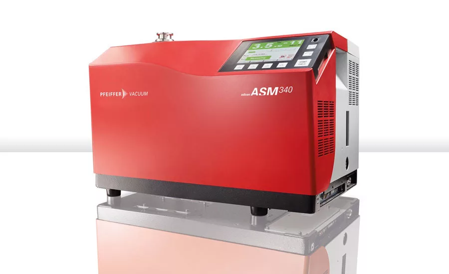

Advantages of a mass spectrometer leak detector:
  • High sensitivity to detect the smallest of leaks
  • Global (chamber) or pinpoint leak testing (sniffing) capabilities
  • Testing of large or small component volumes
  • Is not affected by temperature variations
  • Can be utilized in a manual or automated test process
  • Provides full test data recording for traceability of the test
  • Traceable NIST calibration

REDUCING COST/TEST BY RECOVERING THE TEST GAS
Depending on the sensitivity requirement of the test, it will somewhat dictate the concentration of the tracer gas used. For higher concentrations of helium it may be more economical to recover the gas used for the test so it can be reused. There are systems in the market that can recover up to 98% of the gas used for a specific test.
