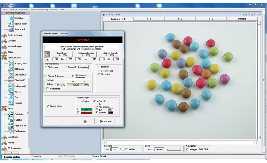

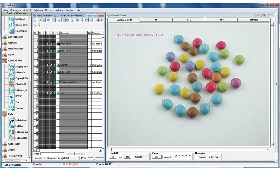

A Blob command can also be used to count colored chocolate drops. In figure 2 – 5 it is shown how the image processing software with a color filter only detects the blue candies and counts them with a Blob command.
A solution with the Blob-analysis can look as follows:

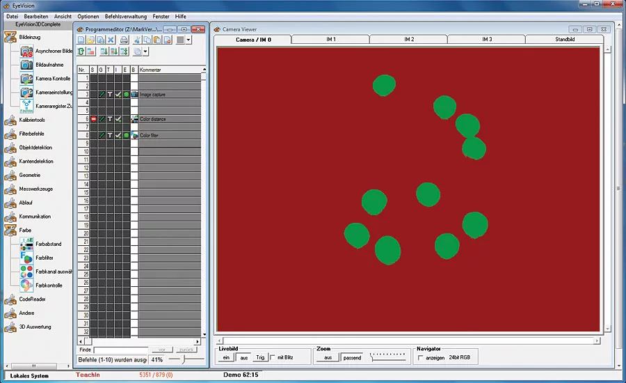

  • Extraction: in the first step a threshold technique is used on the image, to get an area correspondent to the objects (or the object), which have to be inspected. Figure 2 shows the use of a color filter command to only detect the blue candies.
  • Refinement: the area you got with the Extraction can often be impaired by some small errors such as noise or faulty illumination. This can be corrected with the refinement. Figure 2 shows the separated image regions.

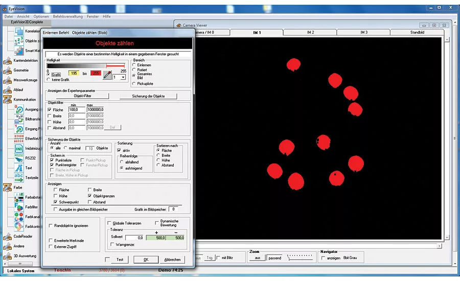

  • Analysis: in the last step the Blob-analysis is used and the result calculated. Figure 4 shows how the command “Object Counting” is used.
  • Figure 5 shows how the blue chocolate drops got a Blob through the Blob-analysis. The application counts 10 candies.
