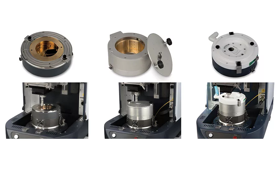

Figure 1. Interchangeable test modules for the UMT TriboLab system from Bruker. Source: Bruker

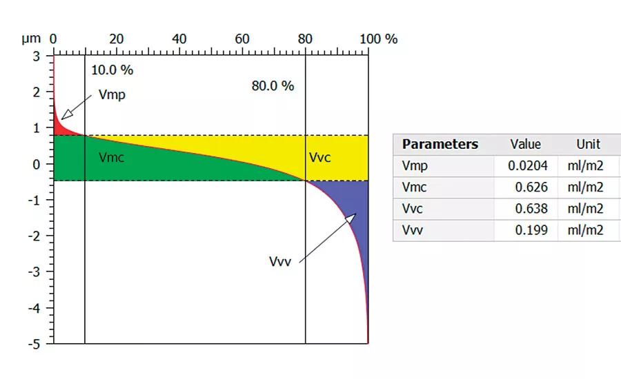

Figure 3. The Abbott-Firestone curve and volume parameters calculated with imaging and metrology software from the measured 3D surface texture data. Source: Bruker

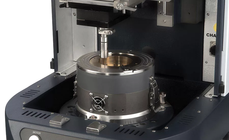

Most commercially available instruments for friction tests are single-function testers, which makes it difficult, if not impossible, to use the same testing equipment for different tests. Even on a single part, there might be several different tests needed to adequately understand performance and durability. And if you are a manufacturer of more than one product, each of the products would need individualized tests. The good news is that there have recently been advances in the testing instrumentation field and there are now some advanced friction testing systems available that offer a range of modules to enable users to run a wide variety of different friction tests on the same testing platform. The better designed systems allow one to change from rotary to reciprocating motion, from sub-newton to kilo-newton force measurements, or from room temperature up to 1000°C for environmental testing. The biggest advantage of these kinds of systems is that they allow the user to more easily tailor tests to specific requirements, which is really the heart of effective testing.

Functional surface texture parameters are related to the distribution of heights and are used to characterize functional behaviors of the surface, such as wear, lubrication, and contact. Using advanced data analysis algorithms, functional surface texture parameters can be calculated and reported from the highly accurate data collected by a 3D optical microscope or optical profiler.
Figure 2 shows an example of the surface texture height map of a piston sample measured by a WLI-based 3D optical microscope, which has the benefit of revealing surface texture in all three dimensions. To quantify the surface texture parameters, engineers typically use analysis techniques such as the Abbott-Firestone curve shown in Figure 3 to decipher the measurement data collected by the 3D optical microscope.
Surface texture parameters defined in ISO 25178, ASME B46.1 and other standards can be easily calculated and reported with modern surface metrology software that is usually included in the 3D optical profiler solutions on the market. For example, the volume parameters summarized in Figure 3 (Vmp or peak material volume; Vmc or core material volume; Vvc or core void volume; and Vvv or valley void volume) help to clearly define the surface’s friction characteristics and lubricant-carrying ability.
