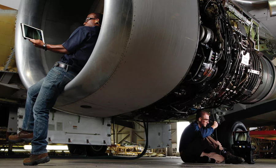

videoscopes
The form factor of videoscopes are increasingly focused on operator comfort. Source: Olympus

Form Factor
The design and form factor of videoscopes are increasingly focused on operator comfort. Videoscopes are used in a wide range of environments from the gear boxes in wind turbines to underground pipelines. To accommodate these diverse and sometimes challenging workspaces, videoscopes are manufactured in numerous shapes and sizes. Some are lightweight and designed for single-handed operation for maximum portability. When portability is crucial, videoscopes tend to have smaller screens and compact bodies with simpler operating systems. Some are built to military standards and are fully outfitted with interchangeable insertion tubes. Videoscopes are available with touch screens, remote controls, and detachable monitors. Some videoscopes can easily mount to a tabletop or workstation. In addition, a growing trend is integrating the carrying case so that it can be used as a stand for the videoscope. Whatever the inspection environment, there is a videoscope designed to best suit the operator, rather than having the operator struggle to accommodate the equipment.
