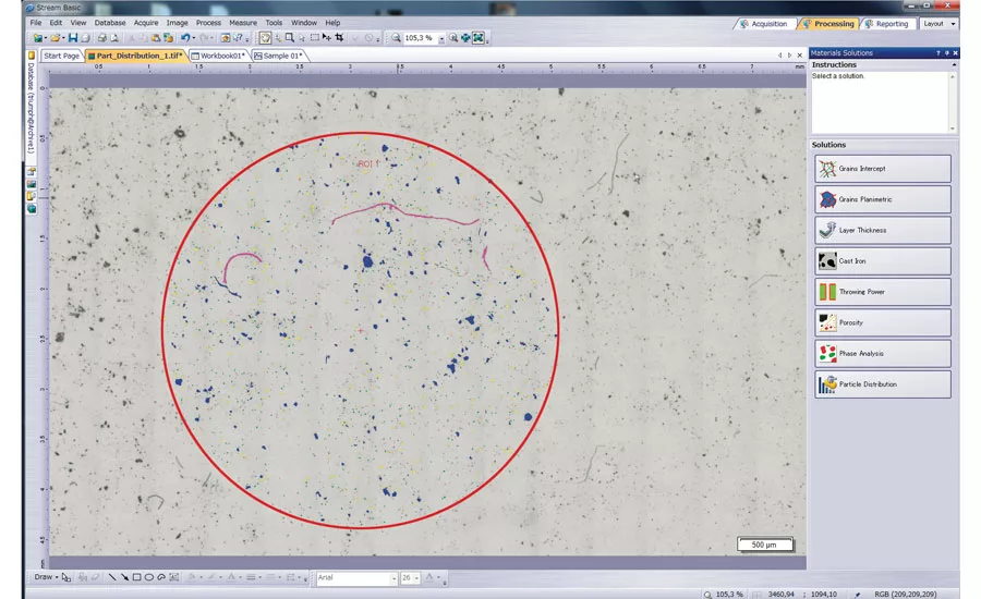

Particle-Distribution
Figure 3: Particle Distribution: Particles extracted on membrane filter. Image created using Olympus Stream image analysis software. Source: Olympus

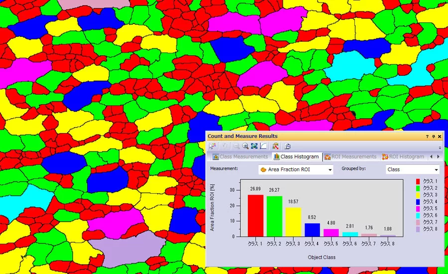

Separate-Object-Filter
Figure 4: Separate Object Filter: Grain boundary detection with area percentage per classification. Image created using Olympus Stream image analysis software. Source: Olympus
Particle distribution (Fig. 3) works similarly but in this case data can be distributed into different classifications based on size. Size is considered differently depending on application so options like area, Feret max, or equivalent circle diameter can be used to define size classifications. Classification distribution can also be considered differently depending on application, so options for particle count, particle percentage, or area-weighted particle percentage can be selected. Typical applications for particle distribution include stability in suspension (e.g., sediments, paints), efficiency of delivery (e.g., asthma inhalers), texture and feel (e.g., food ingredients), and appearance (e.g., powder coatings and inks).

If none of these methods meets your specific requirements, a comprehensive object detection and classification solution should fit your needs. Count and Measure utilizes threshold detection to identify materials in a sample. Classification and Distribution can be performed by more than 50 different options including shape, size, position, and pixel properties. Filters can be used in conjunction with each classification to refine the resulting data (Fig. 4). All data can be output to workbooks and reports for clear presentation of your results.
