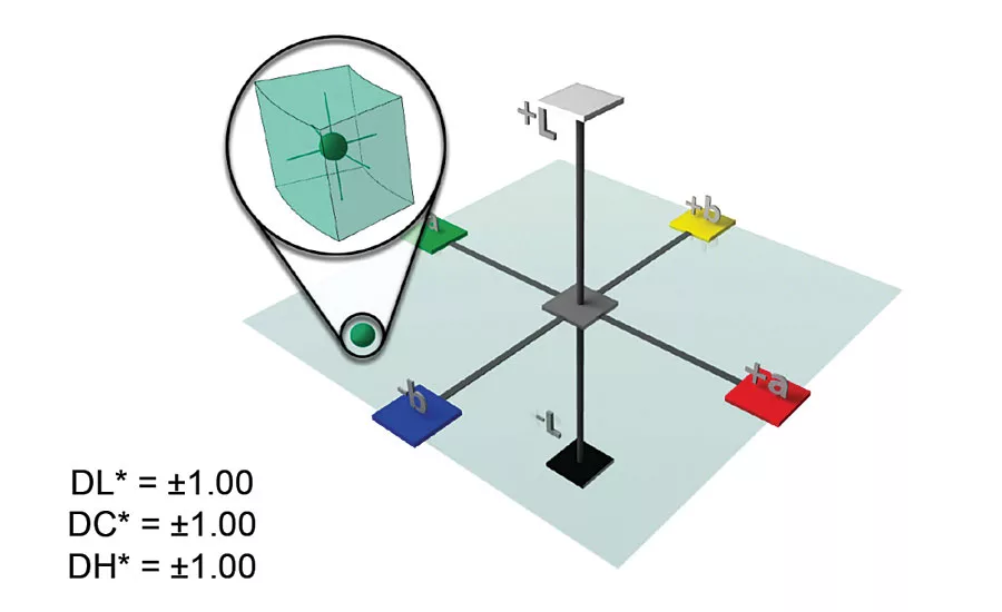

1. Color must be quantified.
How else can you communicate it? You can’t just say to a supplier that a specific part has to be bright blue, or have a touch more red. These are subjective color descriptions that create confusion. This approach is asking for trouble— including hours of trial and error to get just that touch more red into the formulation! But if your customer tells you he or she wants you to match his color standard within a tolerance of DL*1, DC*1 and DH*1, you can produce the color with confidence! Capturing color data using high quality, reliable color measurement instruments is a must here.

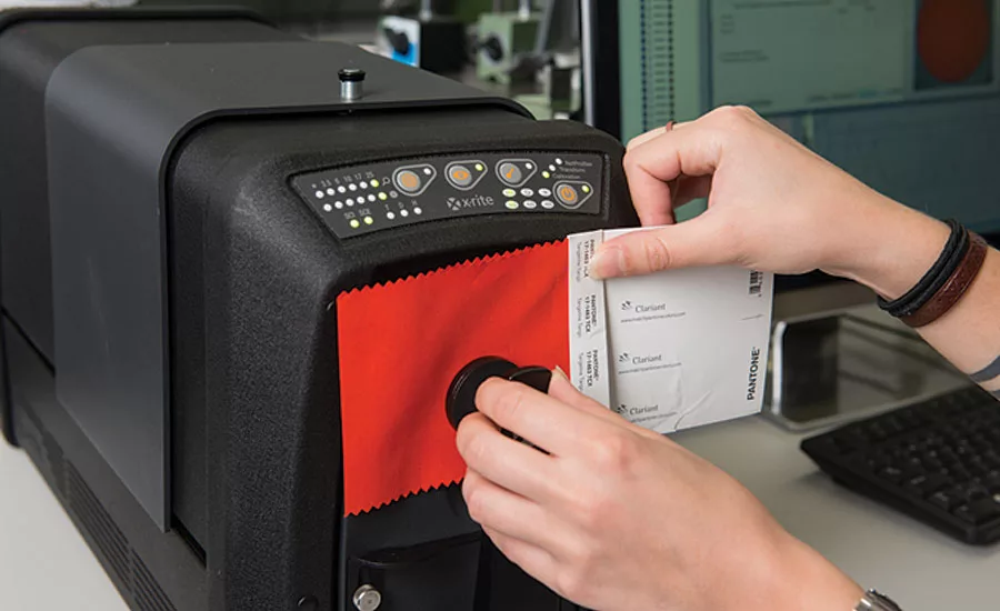

2. You can’t rely on a spectrophotometer alone.
A color measurement instrument is a critical element of any color program, but it’s just that—an element and only the first step in establishing color control. A calibrated spectrophotometer captures the color data, but you need quality control software that you can use to analyze, track and communicate that color. You also need a calibrated light booth for quality control. When used together, these three tools address both visual and instrumental evaluation and approval.

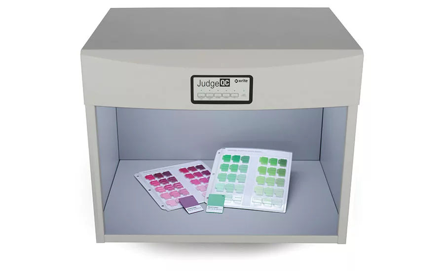

3. Viewing samples outside under ‘daylight’ does not comply with standard D65 lighting!
It may seem like you’re saving money by not investing in a light booth, but it will actually cost you more in the long run. Natural daylight is dynamic. If you are bringing samples outside to view in daylight conditions, what happens if it’s cloudy? Or if you evaluate color at 10 a.m. and then at 4 p.m.? Each time the color will look different.
The benefit of a calibrated light booth is that it offers consistent lighting conditions under which to evaluate color. It also comes with light sources that comply with CIE standard illuminant values, which are used for calculating colorimetrics in quality control software. Controlled, standards-compliant lighting lets you make confident decisions, quickly and easily evaluating whether color is right.

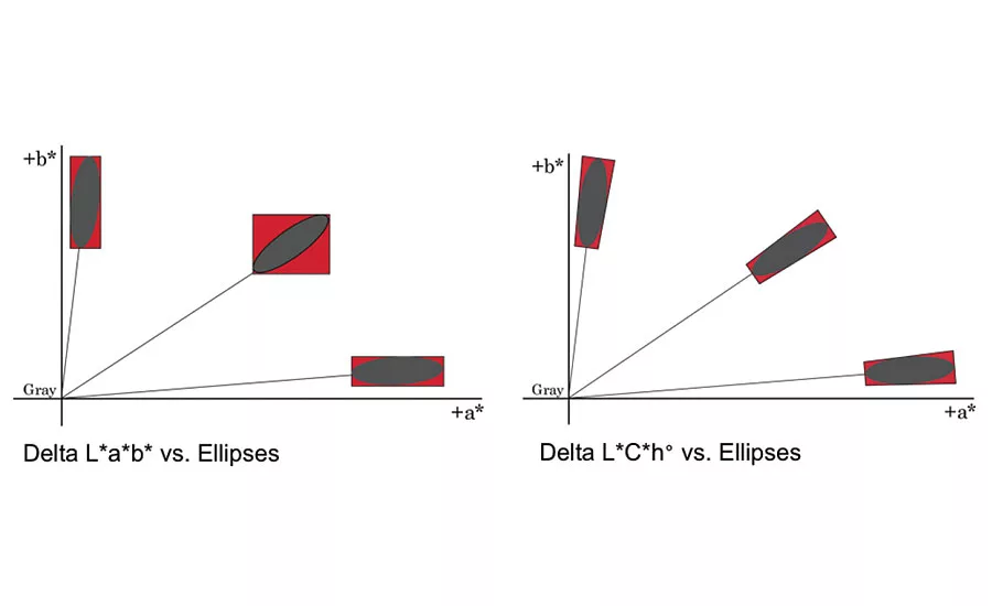

5. Are you using the right Delta E tolerancing model?
Did you know that there are many types of Delta E tolerancing models, and several of them are obsolete? Some companies are still utilizing the older tolerancing models without even realizing it. Spherical tolerancing, such as the original Hunter Delta E, CIE DeltaE*, and others are static and don’t work visually in some areas of color space. For example, did you know it’s harder for humans to detect differences in darker colors than lighter colors? Although you can pinpoint a color and give it a name, these older models don’t address the dynamic nature of color space.
In the past 50 years there has been much study of and research into the measurement of color and the ability to control shade so that both seller and buyer agree when quality is acceptable. As technology improves, so do tolerancing methods. The newer elliptical methods are the best performers so far, with DEcmc, DE94, and DE2000 leading the pack in visual accuracy. Of course, change is difficult (and expensive). If you are using an outdated spherical tolerance model and are having high rates of customer rejects, it might be time to talk to a color management expert about updating your tolerance model.
6. Different people speak different color languages. Some colorists speak Munsell’s language of L*C*h while others speak the L*a*b dialect of industrial science.
Both are methods for calculating color. One is not necessarily better than the other, you just need to understand which language everyone is using. L*C*h° focuses on lightness, chroma and hue, but that information may not have the same meaning to a scientist in a lab tinting and shading a batch of product. This is where color management software can help by doing the L*C*h° to L*a*b* conversion for you.
Here both methods of color specification are illustrated. The first method is L*a*b* and the second L*C*H*. Remember that the area outside of the perception ellipse is still recorded as “good” by the software. This is a color that would pass inspection instrumentally, yet be visually poor to a trained eye. Making sure there is alignment in the color management process between designers and engineering is a critical step in the process. If you were at the beginning of a color control QA program and could build your data either way, which method
